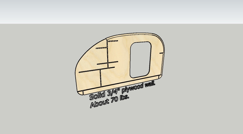

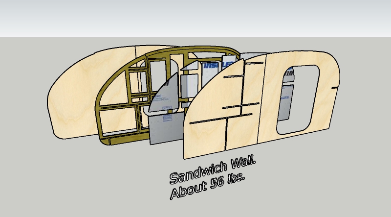

I had been struggling with the same question. But I keep leaning toward solid 3/4" birch ply. It's only about 14 lbs. heavier than the sandwiched method (per side), and should be a lot easier to construct.

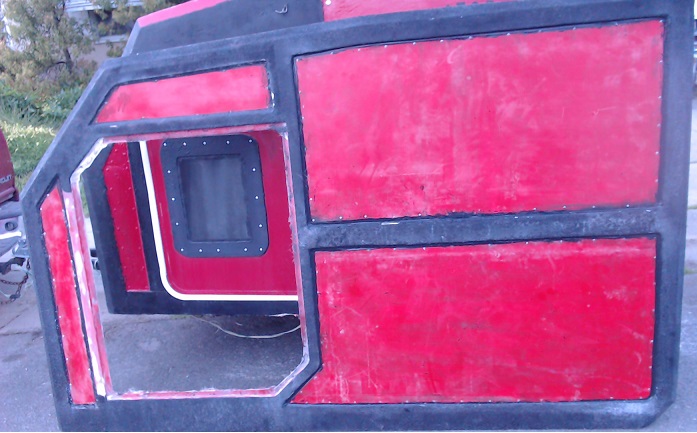

Postby saywhatthat » Mon May 13, 2019 11:45 pm
[attachment]
Picture 460.jpg (103.53 KiB) Viewed 4535 times
I can not see building anything that could rot . like skeleton frame
