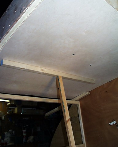

It's 13 degrees out but just like the mail man, I ain't gonna let a little weather stop me. I installed the second piece of birch for the ceiling this afternoon. All I can say is thank God for trim. I got more gaps then a hillbillys dentures. I used a 2X2 dead man to hold the panel in place while I glued and nailed it up. I also ran a couple screws through where the vent will be cutout into a piece of scrap to squeeze the ceiling down good around the vent framing. I hope to finish up my tongue box this weekend and run some more wiring. Then I can put some insulation in.

s4son wrote:It's 13 degrees out but just like the mail man, I ain't gonna let a little weather stop me. I installed the second piece of birch for the ceiling this afternoon. All I can say is thank God for trim. I got more gaps then a hillbillys dentures. I used a 2X2 dead man to hold the panel in place while I glued and nailed it up. I also ran a couple screws through where the vent will be cutout into a piece of scrap to squeeze the ceiling down good around the vent framing. I hope to finish up my tongue box this weekend and run some more wiring. Then I can put some insulation in.

Thanks for the picture! I'm planning on installing my ceiling first thing in the morning and wasn't quite sure how I was going to hold it in place while I nailed it. Now I know!
I've cut the ceiling panels and am waiting for the first coat of finish to dry before I head out and spray another coat. I'll have the remaining coats on before I head off to bed this evening. This afternoon I bought the wood to build the bulkhead between the cabin and the galley. I'm hoping that this will be a very productive weekend!

Yep, when installing the ceiling by yourself, you have to improvise. Watch out for the glue. :lol:
