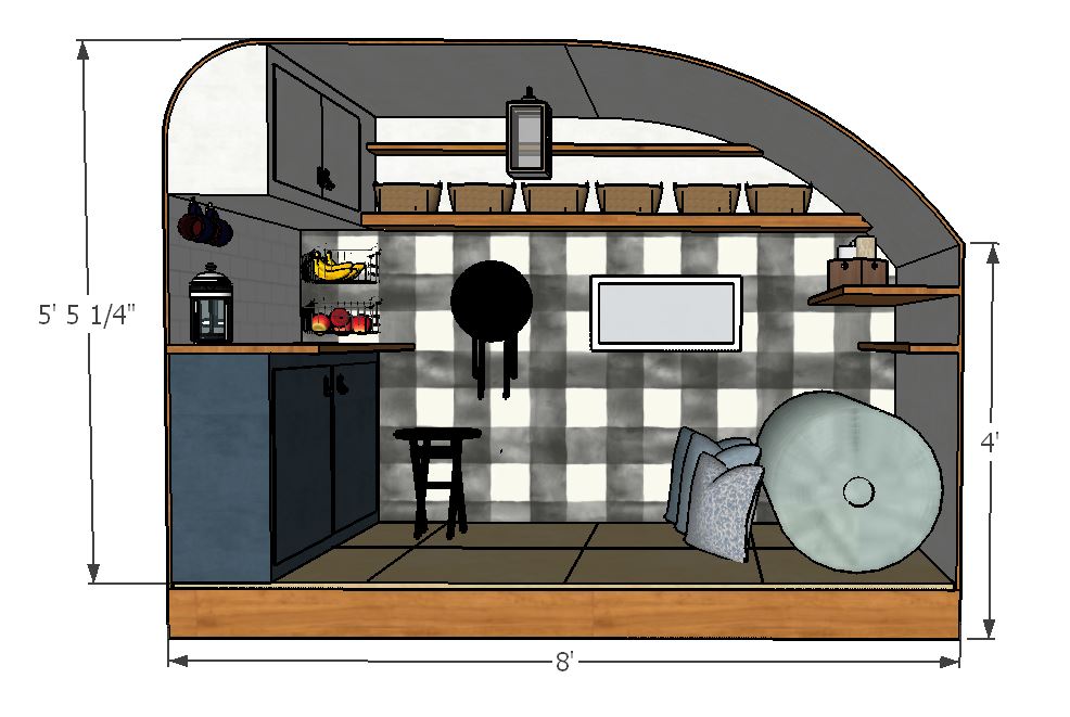

Ok I really really don't know what I am doing so if your responses could be in layman's terms that would really help!
We want to build a cross between a teardrop trailer and a mini camper. It will be for both travel and a potential bug-out vehicle if needed. My husband and I both work from home so it would be great if we could have a space to work so we can travel and work. I want the galley on the inside and I want the ceiling a little higher than most teardrops which is what makes it a bit like a mini camper trailer cross over. I also want to great an 8" drop storage in the floor. Storage is important with this! We drive a car so keeping this as lightweight as possible is also important. I have a few questions that I am having a hard time finding answers to.
What do you use as the base? Thick treated plywood?
For the floor storage there will be braces every 2', how thick does the plywood covering it needs to be to keep from bowing?
I noticed a lot of people use luan plywood for the top. Is there another layer underneath that besides the braces? What needs to be done to make sure that is sturdy? It seems like just laying some bendy plywood over the top isn't going to work well.
What is the minimum thickness the plywood for the walls should be? We want to cut the frame out of one piece so we thought about getting 4 pieces of 4x8 plywood and glueing two over the other two crossway - would this work?
I am going to post my renderings so far! I should have curved the roof but going back and doing that now would be a pain. Let me know if you see any obvious flaws or improvements!
Thanks in advance!

Welcome to the forum,
From your drawing it looks like it will be a tight fit when it's in the bed mode.
You might consider suspending the lower cabinet (shorten it in height) about 18" from the floor so your feet can go under it comfortably.
You could also make the total length of the trailer a little longer by either splining extra plywood on to the total length or find sheets that are 10' long.
The base you speak of I'm assuming is the floor.
I use a good quality 3/4" plywood for the floor and walls, others may frame and insulate or cut out parts of the plywood and insulate which requires another thickness of like 1/8" or 1/4" plywood.
I use 1/8" Baltic Birch plywood for the roof and then another course of the same glued and stapled in the opposite direction to make a stress 1/4" roof.
Is the front of the trailer the 4' end ? :D Danny

Also ply that seems very bendy and flimsy as a lone sheet gets surprisingly strong when everything is tied together. It is really easy to overdo it and get heavy.

I recommend you build a mock up of your kitchen and see how usable it is. Elbow room might be an issue. Carrying food outside to eat might be an problem with a typical teardrop door. There's a reason most galleys are outside.

To point out a few things:
There is no door ? or windows ?
There is no ventilation -- fans, etc. Generally one installs a through the roof fan. There are other options.
You have no placement of any electrical components - DC or AC. You could do without both, but most people want one or both. This is needed for lighting and fan and working while traveling (?). And they take up space. This will determine if you can work when boondocking. Reserving a site with electricity does not mean you will get electricity at your site.
There is no obvious feed prep/cooking supplies/food storage area unless the cabinet in the front is this. Again, you could do without it and use outdoor tables and store everything in the tow vehicle. However, this increases the packing time as more supplies need to be packed before the trip.
Water storage might be needed. Some travel with very little -- as little as 5 gal. And it can be stored in the tow vehicle.
Your floor thickness depends to some extent if you are sleeping on it or crawling on it or walking on it. The weight per square inch changes. For just sleeping, 1/2" would definitely work. And you can go thinner.
Roofs are often a sandwich design ie a layer of plywood (1/8" or 1/4"), joists (1 1/2 - 2" thick with insulation) running across, and outer layer of plywood (1/8" or 1/4"). Although it may not be strong enough to climb on, it is pretty strong.
Under floor storage is doable. A big issue is how to get to the items. Lifting floors inside the trailer is often difficult. Reaching in from the outside can be equally difficult. This is compounded by items like a mattress or any items stored on the floor inside the trailer.
Cooking inside such a small volume is not the best plan. The smells will linger. Messes are impacting your sleeping area. Unless you are very short and thin, that space is extremely small. For example, our original kitchen had less then 5' between the peninsula and the sink and was difficult to have 2 people there. The remodeled one has 9' which is much better. And the peninsula and sink are not vertical walls.
Wall thickness depends on how much insulation you want. Two sheets of plywood offer almost no insulation. It is often cold in the morning even in summer. And it can get very hot if the trailer is in direct sunlight. So another thing to consider.
Besides weight, the cross section area of the trailer affects your towing. Especially if the trailer is taller or wider than the tow vehicle. The trailer is in your case, the 5 1/2' plus the floor/storage plus the height of the trailer frame and suspension. So it will most likely be taller than your car.
Remember these trailer, especially smaller ones are often treated as hard tents. Most of your activities are outside. Obviously rain days can be difficult.

I think your scale from what you vision in your head and real life might be off. Take some masking tape and tape an outline on a wall and see if you can live and work in that space. I think it will be much tighter that you think.
But if it is the right size consider doors on both sides. It makes it easier at night for a potty run that you don't have to climb over your mate. Consider adding 2' and moving the galley to the outside. Do you really want to cook bacon in such a small space? And what's camping without bacon?
Any kind of treated wood has no place in a camper.

Postby sarahem » Mon Aug 26, 2019 2:46 am
KTM_Guy wrote:I think your scale from what you vision in your head and real life might be off. Take some masking tape and tape an outline on a wall and see if you can live and work in that space. I think it will be much tighter that you think.
Todd
Thanks I'll try that!
As for the gallery it's more of a workspace and maybe some simple food prep, almost all cooking will be done outside. No cooking bacon in there. :)

troubleScottie wrote:To point out a few things:
Hi! Thanks for the feedback. There is a door, it's just on the hidden wall in the rendering. There's a window in there too!
As for power we are still looking into it. We want to go solar but determining what we would need is a challenge since it's like learning a whole new language.
Are there pre-built vents we can buy and install? How would you recommend doing this?
Most cooking will be done outside. The indoor space is more for working and minimal food prep on bad weather days.

Hi Danny!
Thank you that's all very helpful! I wasn't sure if the camper could overhang on the trailer a little bit since the trailer is 4'x8'? Would hanging over a foot or two be OK?

So they would need to be powered right? What if we decided to go without power. What do people do then?
Two people in a teardrop need lots of ventilation. Two screened side windows with a top-vent fan are my minimums. I had a teardrop without a roof fan and it was a problem. When I got a tour of a teardrop with a fan, I was building within three weeks.
And speaking of which, If you are going to work in that space, you'll need lights. A 12-volt system is simple to install while building. It'll also give you a way to charge your computers and phones.
The other thing that jumps out at me is the one-door concept that Todd caught. That would drive my wife and me nuts at night (and during bed-making time). Teardrops need two doors.
