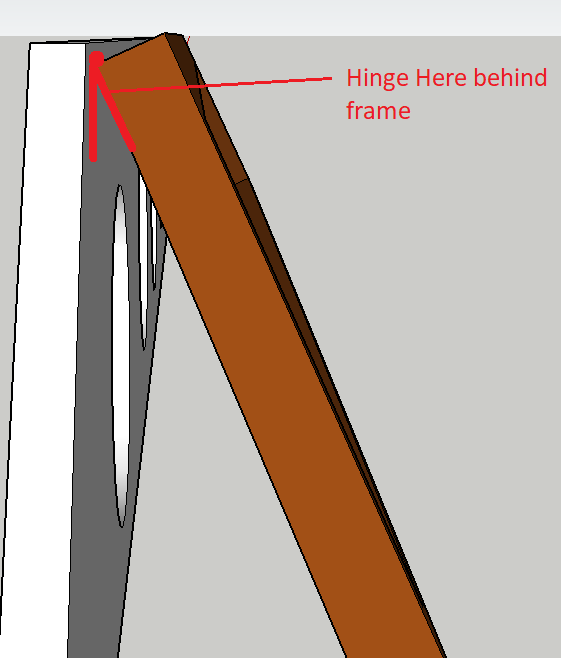

You could put the hinge behind the window frame like this which to me looks like the best idea.

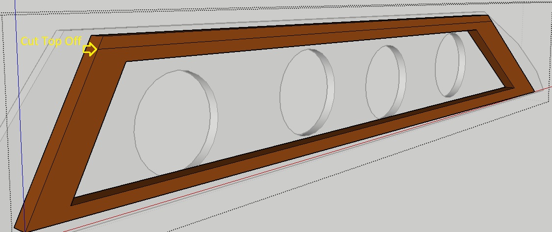

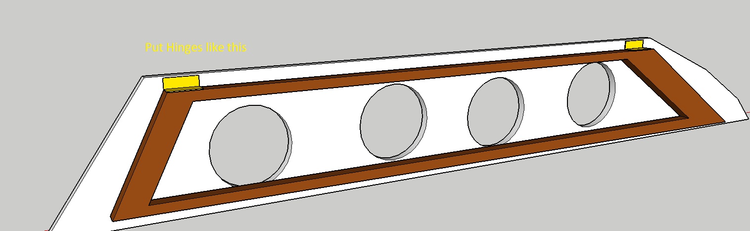

Or you could trim the top off the frame and put the hinge like this

Thanks for the drawings.
You are right I can cut more off. and had not thought of a reverse hinge.
My problem before was I could not open it wide enough to attach the hinge at the back.

Postby Ron Dickey » Wed Oct 09, 2019 10:14 pm
I cut the top and bought smaller brass hinge. Looks like it will work :applause:
