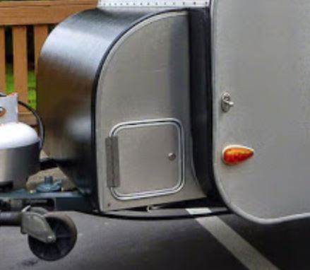

Can anyone offer some tips for DIY compartment doors? What types of trims and seals, minimum corner radius, or squared-off corners, etc?
I would like an 8" x 10" door for my tongue storage box, but I can't seem to find a pre-manufactured door smaller than 9" x 12".
How does Camp-Inn do it?
I assume you are asking about the trim.
It's a matter of finding the right dead-soft trim. But if it's not soft, you can take the stiffness out with a torch.
So-Cal sells some 1/2" "nosing" trim that may work. You would want to cut a mock-up first to ensure the rim will make the curve.
I may have bought that trim from Vintage. :thinking:

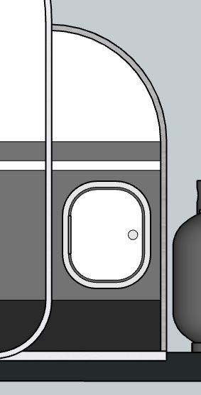

Tony, If I can easily bend that trim to a 3" radius, I will be happy. I was thinking it would look something like this with a trim-lok seal.
(Hmm, now that I've detailed it, it doesn't look too difficult.)

Postby tony.latham » Sat Oct 19, 2019 3:24 pm
I don't know how you'd take that aluminum angle (?) doorstop all the way around.

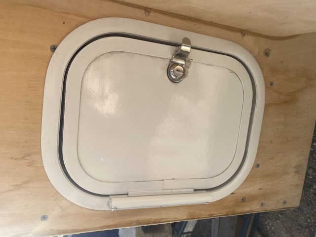

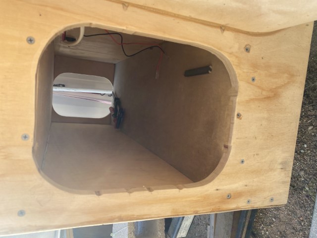

Postby eLink » Fri Feb 25, 2022 12:03 pm
I guess I can thank the spammer for resurrecting this post!
But to follow up, I ended up buying the smallest pre-fab door I could find: a 9"x12" from RecPro. I had to widen the previously cut hole by about 1 inch all around. It fits really tight to the floor and ceiling of the compartment, but it'll do.
