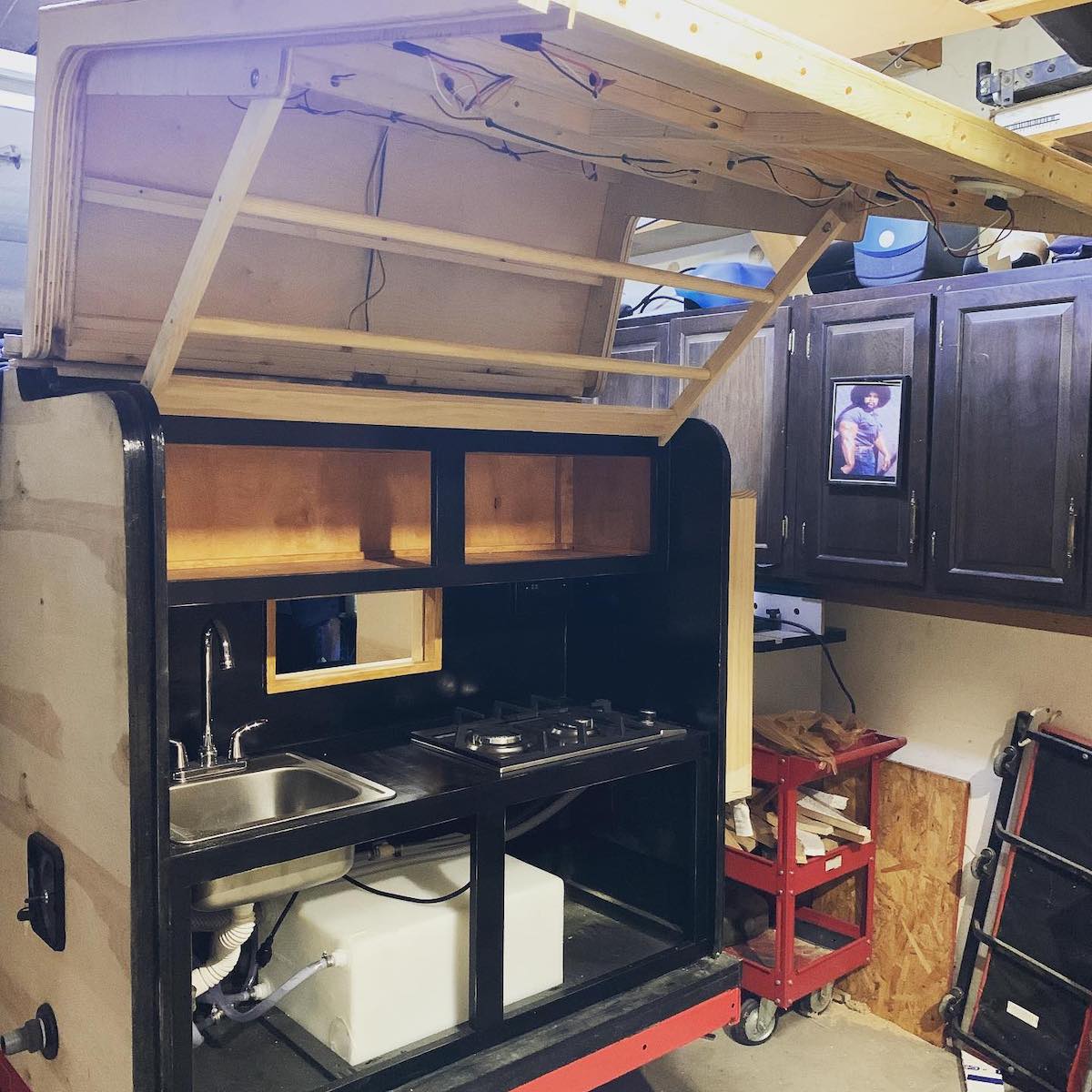

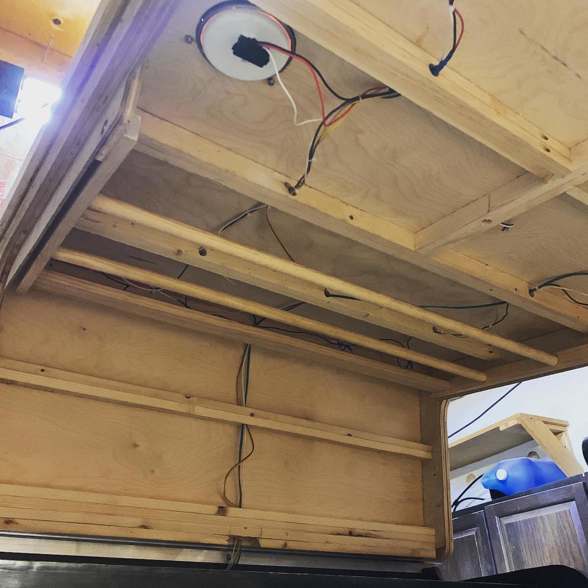

Oh yeah, I forgot to update you all. This is what I decided to build until I decide to figure out gas struts, if I ever go that route.
This pivots down and 45dg cut outs allow this to rest securely on the upper cabinet. When I want to close the hatch, I lift the hatch a bit and rest this support on top of the cabinet. As I manually close the hatch, the support folds into place. I'll eventually add magnets to it so I can secure it to the inside of the hatch once I get my interior hatch walls installed. This turned out to be pretty nice actually. The dowels can be used to hang things on to dry or whatnot.
If you look carefully at the 1st photo you can see the rack / support tucked up inside the hatch. You can see the pivot points where it comes down to rest on the cabinet.

Postby drhill » Fri Dec 13, 2019 3:44 pm
That hatch support/towel rack will work great. No need to spend money on struts.
One suggestion I would make though, is consider adding some sort of safety pin to stop the hatch from being lifted (and then dropped) when there is a gust of wind from behind with the hatch open. I added some safety pins to mine and have only used them on a couple occasions be they are nice to have when camping in the open in Moab or next to the ocean where wind can be a problem.
