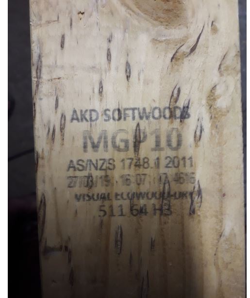

The timber was "tanalised" at plant #511 with azole preservative #64 to durability class H3 - outdoor above ground exposure.
Timber Label

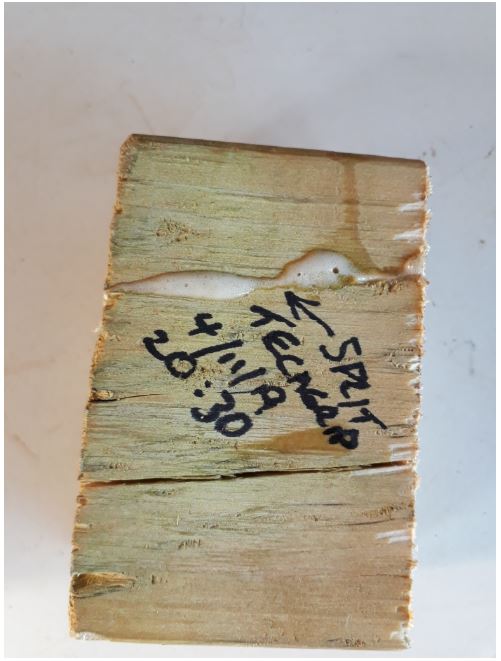

I cut 2 inches off the end of a stick. The piece promptly split in two. Since I don't really want to open a $33 tube of sika flex 252 until I'm ready to go, I thought I'd start by gluing this two inch piece back together with the Sikabond Tech Grip polyurethane. This stuff seems the equivalent of Gorilla Glue polyurethane.
Apply to one surface sparingly, it said.
Then I clamped it lightly together, at which point it became obvious that Sikabond has a different interpretation of sparingly than I do, as glue squeezed out every surface. This bottle of glue is going to go a long way.
Glued Joint Tech Grip.JPG (54.81 KiB) Viewed 5132 times
After an hour the glue has begun to froth a bit. This is "normal" for polyurethane I have read.
I intended to dampen the surface I didn't apply the glue to, but forgot in my haste.
I blame the 12 hour day at work. Still the fact that it is frothing suggessts that the glue is doing what it should.
I'll give it the recommnded 24 hours, sand the surface of the glued 2 inch piece and the same size surface area on the long stick it came from and see if I can glue the two pieces back together on the surfaces that always feel funny to me.

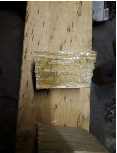

So I went straight to the shed when I got home from work.
24 hour cure.JPG (50.04 KiB) Viewed 5046 times
The squeezed out glue was opaque, hard, and seemed to cut off easily with a wood chisel.
I wanted to be at least a little bit scientific, and measure the breaking strength somehow.
So I decided to mount the test piece in the vise and use a torque wrench to twist it.
To get a grip I used a three-legged oil filter wrench spaced out with a bit of square tube.
Started off at 10 ft-lbs. Wrench went click.
Up to 20 ft-lbs. Click. And so it went.
I was really starting to lace into it at 60 ft-lbs of twiisting force when my son said, "you're bending the filter wrench"
So, at some point north of 50 ft-lbs the filter wrench was weaker than the timber and the glue.
Called it a day and said "Strong enough for me".
Joint area 35mm x 56mm.

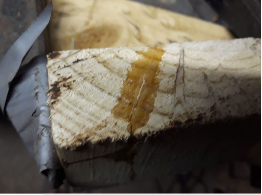

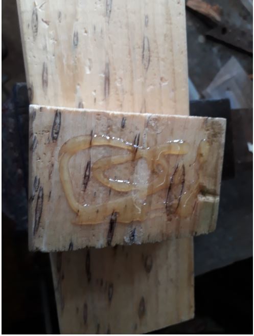

So then I scrubbed a wide face on the glued piece with a wet rag. Did the same on the end of the long stick it came from, let it dry a moment and smeared on some more TechGrip.
Lightly clamped, we'll see how the gluing of un-sanded surfaces of LOSP treated pine goes tomorrow night.

edgeau wrote:Up here in QLD I have never needed to wet the wood as we are always so humid.
Sent from my Pixel 3 using Tapatalk
First bond I did not wet it, it was a clean fresh break that didn't need cleaning. It set fine overnight.
For the second test, I scrubbed with a wet towel just to clean the timber which has been lying around for a while.
It certainly set quicker this time, though.
Which appears to mean you can actually have some control over the set time.
I really like this glue. It swells a bit, presumably because of the water uptake, so good gap filling, and you really do need to use it very sparingly, which makes it much more cost effective.
