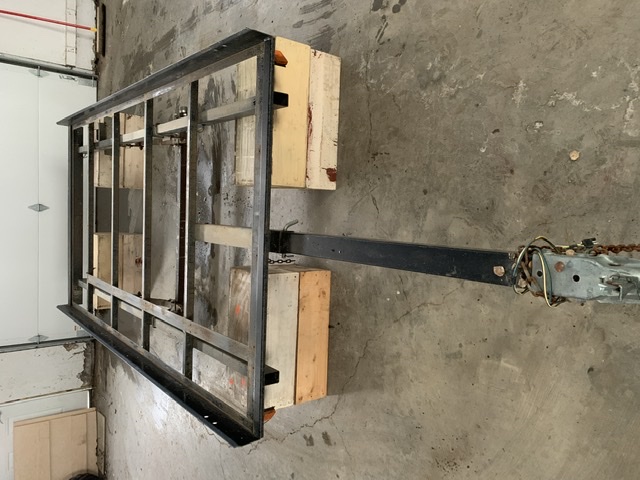

I have been given a trailer that I’m going to use for a pseudo-standy-squareback.
The trailer has a metal edge down the long edges - see photo
Trailer
I don’t want to cut off the whole thing because it seems fairly structural.

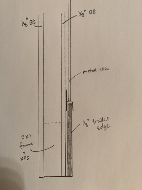

Originally I planned to build the wall to encase it - see sketch - but this will make the walls slightly too wide apart to use a sheet of 5’ BB on the roof. The width across the trailer to the outside of the vertical part of the metal side is 5’ exactly.
Option 1
Alternatively I could build the walls inside the metal side, cut off the lip, and add a flashing on top of the cut edge and under the metal skin.
Option 2
Another issue is that I want to extend the length 1’ past the end of the trailer to accommodate some of my wife’s wish list: galley, full bed foldable along length, bunk across front for child. If the metal side is exposed it won’t cover the extra length but maybe I can be creative with some checker plate or similar.

How about building the torsion box floor exactly 5' wide, then rabbet the edges so it sets over the frame. Set your wall flush with the edge of the floor and your skin will go down over the frame, like this:

Homebrewer25 wrote:How about building the torsion box floor exactly 5' wide, then rabbet the edges so it sets over the frame. Set your wall flush with the edge of the floor and your skin will go down over the frame, like this:
160681
I think this a good suggestion but wouldn’t I would have to cut off the lip at the top of the metal edge?
