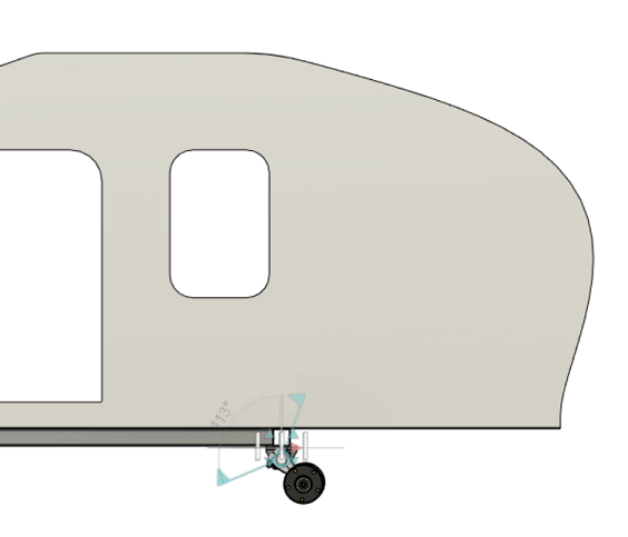

Hi all,

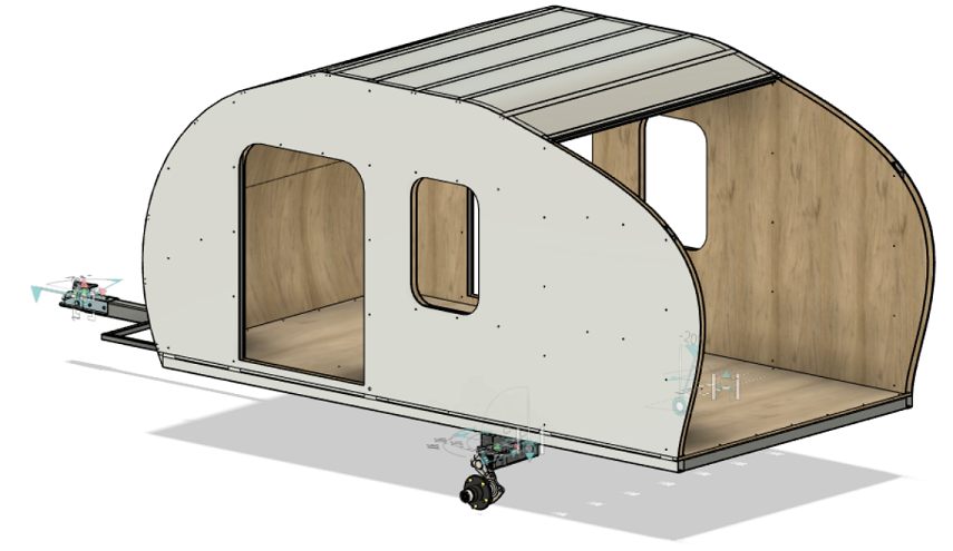

I'm Geoff, and this is my first post here. I'm in the process of designing a teardrop and have found a lot of good information on this forum. I've never built a teardrop and I have yet to get off the tube to begin prototyping of any sort - so before I get too excited and too far down any one path, I figured it's time to start asking for feedback. I couldn't find a build thread where anyone had attempted something like this, but if there's any out there I would definitely appreciate the link(s).
So for all of you hatch experts, how difficult do you feel it would be to construct a hatch for the profile below using "industry-standard" techniques (i.e. vertical wooden ribs that define the profile, horizontal wooden ribs for stiffness, plywood skin on exterior / interior)? It looks like sealing could be a major issue if there's even the slightest bit of warpage in the hatch relative to the walls due to the dual-radius nature of the profile. I'd like the hatch to extend all the way to the frame, not above it as I've seen some similar builds done. I'm highly driven to make this shape work if I can, and pursuing the wooden construction route is preferable for cost reasons as opposed to laser cut or waterjet aluminum parts (though this is an option). Has anyone ever done this? Thoughts, questions, criticism?
Thanks ahead of time.
Hatch Profile Iso.PNG (280.58 KiB) Viewed 3277 times
Hatch Profile XZ.PNG (41.8 KiB) Viewed 3277 times

It is more extreme than I did but I did have two radii to make my shape. I only went to vertical not back under like your plan. What I failed to consider was the grain direction in my ribs. Once I put the ply on I had 1 or 2 cm spring back. Get the ply that is made to be flexible for the skin and use plenty of 'the mix' to seal it.
How wide is your cabin? And how long is your hatch? I would make sure the hatch can be covered with a single (5'x5') sheet of Baltic birch assuming it isn't greater than 5' in width.

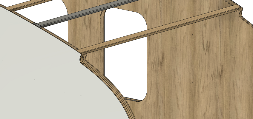

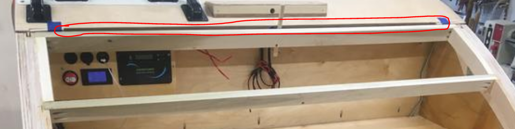

I build using a modified Fredrick's style hatch. Dust and waterproof. "Industry standard?" Perhaps not, but this style hatch is popular.
The hatch ends are removed from the walls while still on the bench. The spacers and lip pieces are also added to the galley walls while still on the bench. (The internal galley wall forms a rain gutter and mates with the seal.)
Obviously, I don't see the need for extra ribs in the hatch. (You don't need them in the front curve of the cabin, so why in the hatch?)
Here's the wall/hatch detail. (I build sandwiched walls.)
As far as building with that profile –-as long as it's less than 5' wide-- I don't see a problem with the exception of that little whale tail at the bottom. I'd have to think about it for a night or two.

This post was extremely helpful and has given me some food for thought. I like what you did and I think I could accomplish something similar to the cross section you posted of the hatch detail. The main difference is that my frame will utilize welded steel uprights and crossbeams to do most of the structural lifting - which is what the exterior and interior plywood walls will mount to - but I think I could get away with deleting the 1/8" spacer and the extra 1/4" galley wall, by leaving the interior wall proud relative to the exterior wall. So that the edge of the interior wall is what will interface with the seal on the hatch side. If that is hard to visualize, I will get some photos posted once I get around to making these changes in CAD.

I think the hatch is "do-able" except for perhaps the reverse curve portion at the bottom of the hatch. The ribs/spars won't cause issues, but getting the exterior ply or aluminum to reverse curve will be tough. As Tony stated, a consideration is available material sizes with regard to the length of the hatch. With a long hatch, you will hatch need to butt joint or splice your plywood and lap exterior aluminum. Another consideration of a long hatch is weight.
My hatch is almost 6' in length and has a compound curve. The last portion has a tight radius. I had to butt joint the plywood skin and overlap the aluminum exterior. The plywood is butted at a cross-spar.

Edit: Hatch detail coming along..
What you are seeing is the 3/8” gap between the oak cabin spar and the first hatch spar. The gap is needed to allow the hurricane hinge legs to fit in.
Good eye.

I don't see any problem with the hatch design. "Tumble home" would be the boat-building term for having the reverse curve on the bottom (actually the top decks above the sheer), but it does limit the overall amount of galley space at the bottom. I chose a simple Benroy design to utilize as much floor length as possible (a first build), since we needed all of it for the design & stuff which was going into the build. There just wasn't enough room, without the straight front & rear at the deck. Just keep looking at builds, to make sure you have it all designed & thought out prior to starting. The small stuff can kill you later in the build if something is left out in planning.
