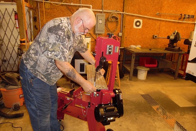

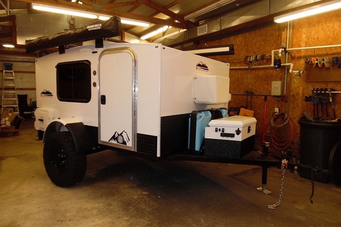

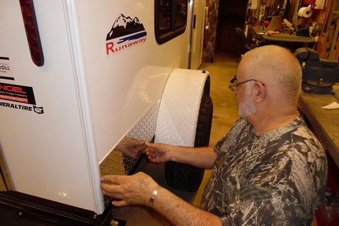

when I was making my " high aluminum diamond plate pieces (rock guards) after cutting them out I media blasted them with glass beads & coated them with 2 stage catalyzed truck bedliner. I wanted to avoid drilling holes to attach these pieces 3 per side. I talked with the manager @ auto body paint supply shop about the best way attaching these pieces w\o drilling holes & using screws or fasteners. He suggested using 2 side automotive molding tape (3M1/2 x 15' Molding Tape), with the 2 sided tape automotive molding primer (3M Tape Primer 94 1/2 Pint).
These aluminum diamond pieces are ahered tight & not coming off any time soon. Personal I would use aluminum diamond plate prepped good with a good quality 2 stage catalyzed truck bedliner sprayed over it. The bedliner has shown any signs of chipping or coming loose. My wife & I do a lot of offroad dispered camping & run many trails & dirt roads.
