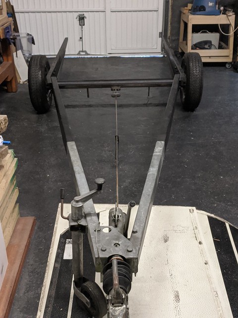

Original trailer frame :
Thanks for any insights.

The floor on that frame provides a bunch of strength. I would suggest using 19mm cross boards and around the perimeter. This will stiffen the floor and provide a stronger attachment for the sides. The reinforcement of the floor adds little weight plus it is low.
That's a good looking caravan in the picture. A nice buildable shape.
