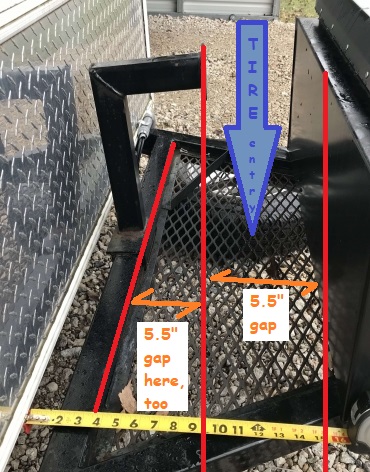

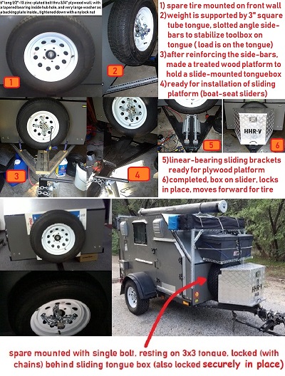

immped64 wrote:In looking at my own setup I can see 1 conceivable way of doing something similar with the materials that I already have on hand. First of all the spare tire mount is fixed to the 2" square tubing by straddling the tubing and being bolted down. The below picture "may" show the straddle, and the fact that at least a narrow 5 inch groove was necessary to get past the internal grating in the tongue area.
plenty of room to roll a spare tire into space allotted
Behind Tongue Box measurements.jpg (98.7 KiB) Viewed 3983 times
* The space you have between front wall and tongue box is perfect to mount a spare. I mounted mine there before I ever found the right box to put on my tongue, and relied on it to furnish much-needed tongue weight in the process. After I got the box, I decided to keep my spare there anyway, so I constructed a triangular mounting platform (slides forward to remove spare), to attach it to the single beam tongue (with lighter-duty outrigger struts for stability).
easy-access to spare after lock removal and box slid forward
Spare tire front mount behind tongue box.jpg (142.43 KiB) Viewed 3983 times
* With the stanchion already in place, you could easily roll your spare into position (with slightly angled maneuvering) and lock it onto the stanchion (a custom bolt placement will lock the tire in place). My spare tire placement worked out great for me, as it is readily accessible, safe from theft (3 locks), and also supports a folding shelf/rack (weight=60 lbs). A complete rationale for this mounting spot is in this thread: http://www.tnttt.com/viewtopic.php?f=42&t=70759&hilit=spare+tire&start=15#p1255280

Postby immped64 » Sat Apr 18, 2020 11:23 am
Working on it:
That is a very imaginative way of utilizing the full space of the tongue area.
My project is a work in progress but I don't believe I could utilize a sliding box as I have my solar controller wiring inside my tongue box.
I actually have between 7.25 and 7.5 distance between the tall mounting stem and my tongue box. The stem is angled towards the cab somehow which helps but I still need a clearance of 8 inches.
