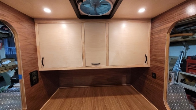

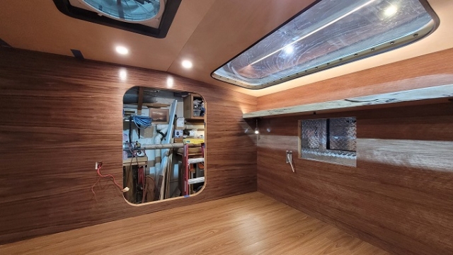

Postby Onajourney » Tue Jun 20, 2023 8:02 am
I used walnut 1/4" ply on the walls and 1/8" baltic birch on the ceiling.
