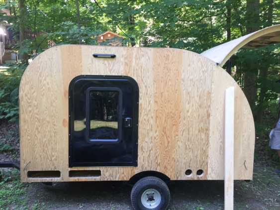

Hi All,
I am having troubles sourcing surface mount water tight access doors. I have attached a picture of the trailer for reference so you can see where i am trying to cover up. I can't use anything that needs to have holes cut to install due to the location of the storage areas. The 2 round ones at the back have PVC tubes running through them currently, the rectangular ones by the front could be either one door or 2 doors. I was hoping someone here would have a lead to some hatches that might fit the bill.
If not I would love some suggestions on how to build some sort of covers that I can use.
Thanks
MJS613

MJS; Take a look in the marine market. I suggest you look at "deck plates" for the round holes, and there might be something out there for the rectangles. Deck plates can be had in white, black, or with a clear center insert. The center is a 1/4 turn remove/replace that allows access. They are not flush mount, but even with surface mounting, they are a rather low profile.
BTW; What size are the round holes?
Roger

Ok I will take a look to see what I can find, the wholes are 4", I have thought about just getting the threaded ends for the PVC tubes and just have the screw on ends but would be nice if I don't have to have things sticking out the side.

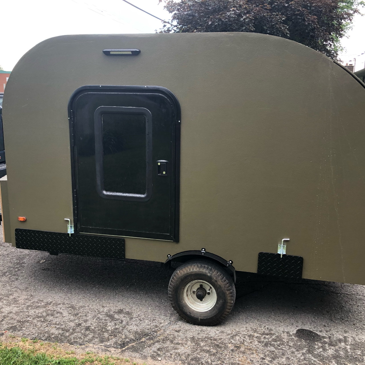

I know this is an old post by me but thought I would give an update. I couldn't find anything that would work so I ended up having some hatch doors made. Though I would share a pic.

looks like a tidy solution. Fits well with the black entry door.
What kind of paint did you use on the body?

I used west system epoxy then sanded and coated with monstaliner roll on truck bed liner. Od green and the roof is cloudy haze and off white.
http://monstaliner.com
They have a Facebook page that's really active.
