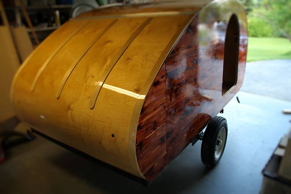

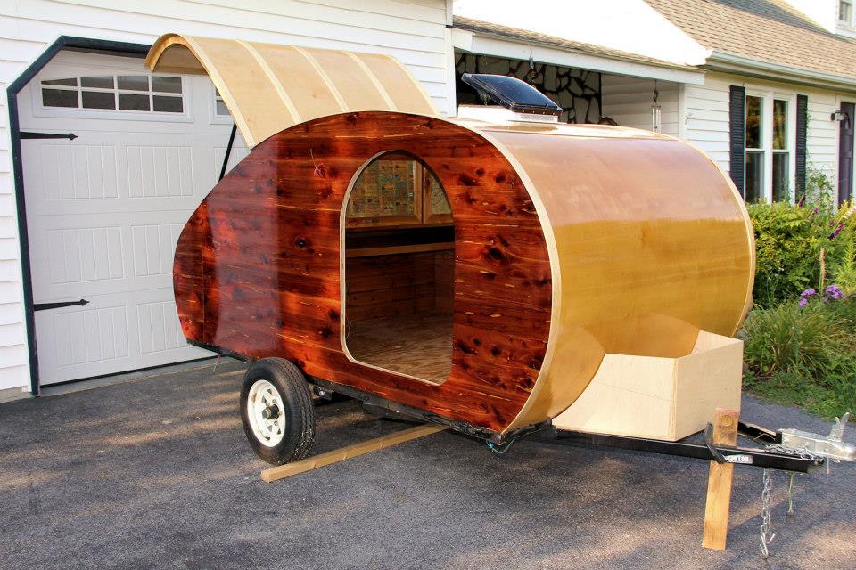

Postby TomMaj » Mon Aug 31, 2020 1:59 pm
Here's a couple pictures during my build years ago. Baltic birch with just 3 coats of epoxy, before I put on multiple coats of varnish.
td fresh coat epoxy 03.jpg (118.07 KiB) Viewed 5038 times
td fresh coat epoxy 04.jpg (51.15 KiB) Viewed 5038 times
TomMaj
Posts: 23
Joined: Mon Apr 27, 2015 3:26 pm
Re: Pic Request: Epoxy over Baltic Birch
Postby tony.latham » Mon Aug 31, 2020 2:55 pm
Sweet Jesus!
You're teardrop is one of "those". One of the teardrops that if I travel as a flight of two 'drops with you, the lookee-Lous just wanna see your camper and ignore mine.
