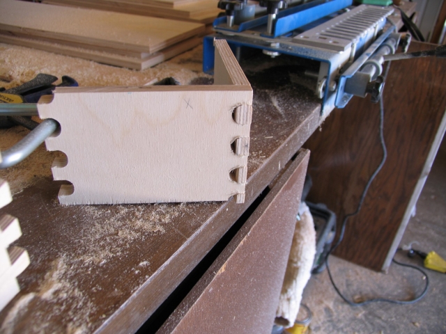

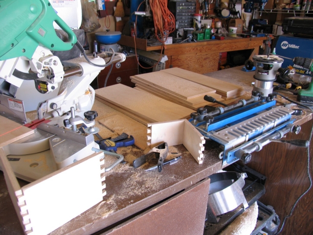

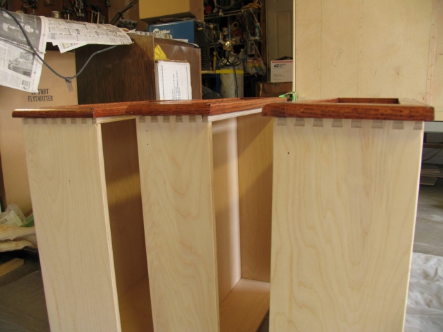

I used a Harbor Freight Tools Dovetail jig to make mine. It takes a bit of fiddling to get the jig setup but then you can rock:
It's cuts a half blind dovetail so you definitely need a drawer front:
I think they came out pretty nice:

Wow those dovetails are great! Beautiful drawers!
