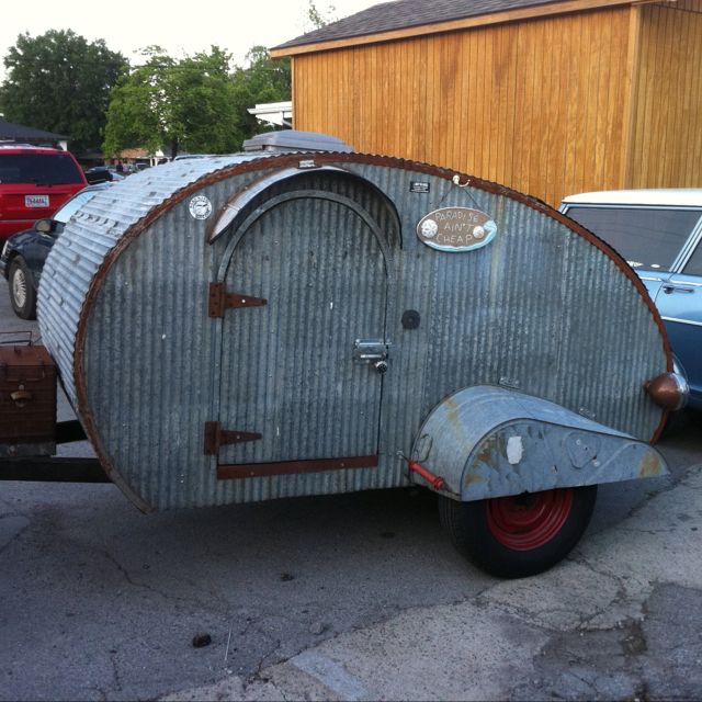

I've seen plenty photo's of corrugated steel panels used in teardrop construction.
Most of the corrugated stuff is seen on rat rod style campers. However it is still steel.
I realize you plan to use flat panels. From a material stand point steel has been used.
