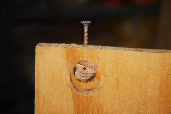

attempt to add screws to pull things together? Drill the plywood and add cross pegs that you can then screw into.
Only you know if the wood is still viable. If its not possible to close the gaps, purchase 'backer rod' found in the isle with the caulking. Caulk both sides of the packed in rod and seal the outside. Realize this may increase the damage with road stresses.
