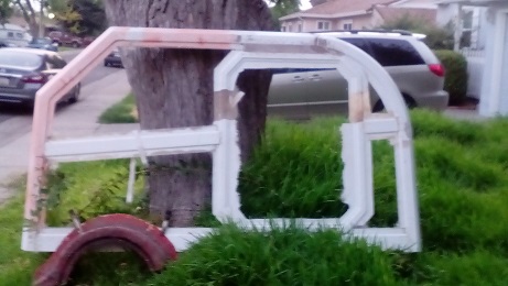

big fan of fiberglass skeleton frame. can work on it 10 to 15 minutes at a time no warping ,easy to fix oh-ho. Never worried if it gets damaged no rot. So easy a caveman could do it. I can glue a join better than cut a strati line in wood
smal skeletonized.jpg (191.14 KiB) Viewed 4780 times
