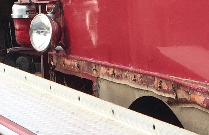

Postby swoody126 » Wed Sep 30, 2020 9:07 am
one possible solution could be from the upholstry industry
WELTING
a piece of cordage(3/16" in this case would cover your 1/8" gaps) wrap'd in a vinyl or fabric that compliments the build
older cars and some more modern builds use it between bolt on components
American LaFrance used welting between the side boxes and main tank enclosure on my '64 firetruck
IMG_4339 2.jpg (89.59 KiB) Viewed 1506 times
just another option
sw
