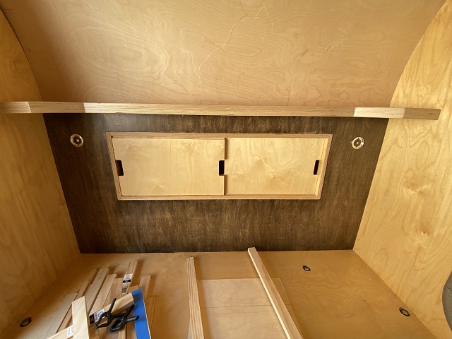

Can you post some photos of your simple headboard shelf?
This is how I do it. Open storage above with a 3-1/2" lip and storage below behind the sliders.

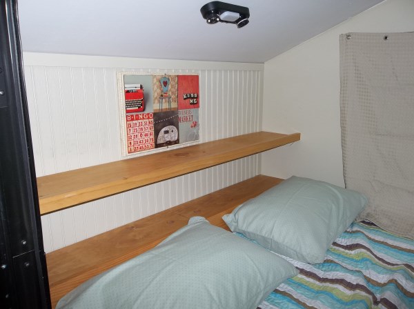

The shelves in my weekender are about as simple as it gets. The bottom shelf is actually two removable pieces with thumb holes for access to DC wiring system. They are all easily removable with pocket screw connections. They are also wide enough to hold small duffel bags and other luggage during travel.

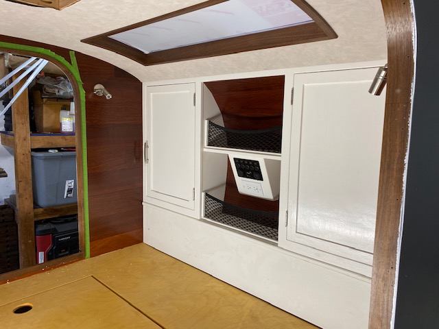

This is the headboard we have. The bottom panel (up against the mattress) is removable, it hides all of my AC and DC power distribution. In the center is a power pod which has USB, main circuit shutoffs, AC power. The shelves in the center have bungee net keeping things in place. Two large cabinet doors hides a pretty narrow storage area. We like the power pod and the shelves with the bungee net. The cabinets are kinda useless, they are too narrow to put much in them and everything falls over. The doors are hard to open when in bed. It looks good in my opinion, just not the ultimate in practicality.

wysedav wrote:This is the headboard we have...
That is very nice. Where do you find bungee nets like this?

Postby wysedav » Tue Jan 19, 2021 10:04 pm
One other thing to note. If you look at the picture I posted, the lights are not in the best place for reading. instead of the side wall I should have put them in the center above the power pod. Where they are now, the book is always in a shadow unless you roll to the side to read.
