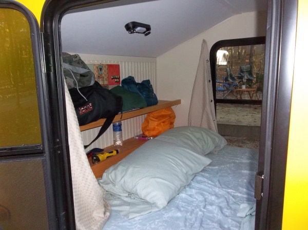

Not hung directly on the door but very easy for in and out. I used a cloth shower curtain (the kind with grommets) cut to cover each door. They are hung from two cup hooks, one in each top corner and you simply lift the corner down during the day for easy access through the doors. Pull it back up at night after you are inside.
This is the only pic I could find but you get the idea when they are fully up.
One side dropped down and out of the way.
