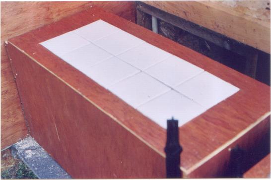

The ceramic tile I put on Chubby had been down 12 years and thousands of miles I just used %100 silicone and grouted with the same ...

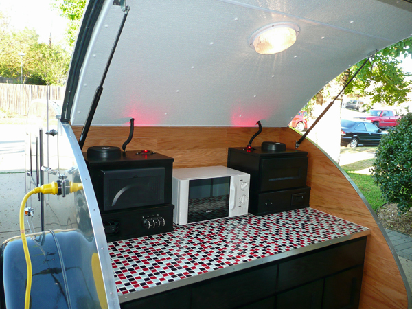

Glass mosaic tile with epoxy grout:
