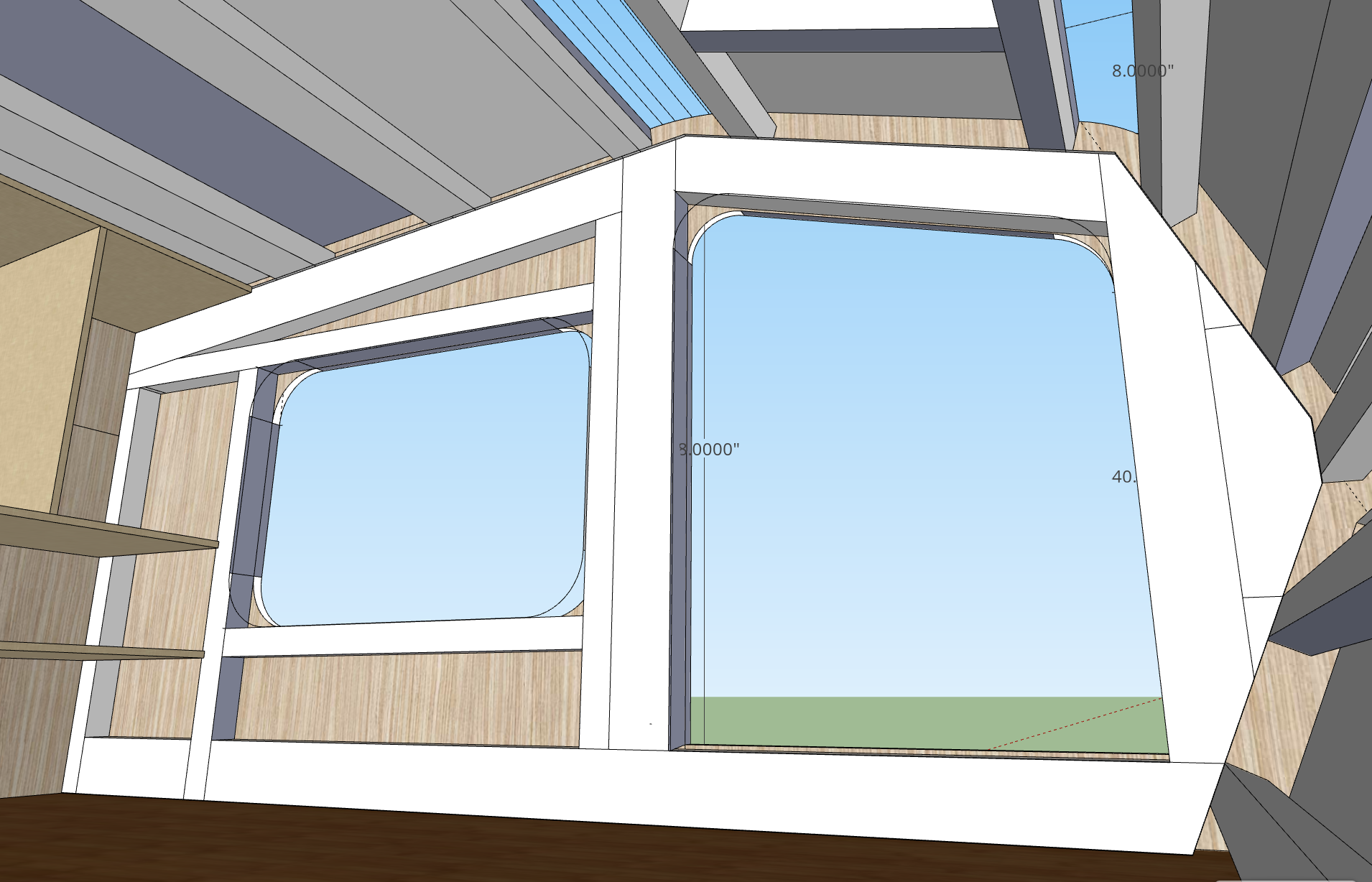

Hey all. I'm pretty new to this community and am currently in the designing phase of my first build. I wanted to get some advice in regards to how I would go about wall and insulation framing. My current build consists of a skeleton of 2x4's and 2x2's sandwiched between 1/4" interior plywood and 3/4" exterior plywood along with insulation in the voids. I am trying to keep this build under 1000 lbs (if thats even possible lol) but I still would like it to be able to have a very solid construction. Are the 2x4's overkill? Should I go with a plywood skeleton? Here's a picture of what I have made so far in regards to modeling:
Thanks for any and all input.
Yes, and yes.
And yes, that's gross overkill too. I think you'll be pushing a lot more than a thousand pounds.

Agree with Tony. ^^^^
Mine is plenty strong using 1x2’s and 1x3’s to make the 3/4” thick skeleton. Titebond II wood glue and a Kreg pocket hole jig are great for fastening the skeleton together. I used 2x2’s for the roof beams. Gluing and screwing the 1/4 ply exterior wall to the skeleton makes it a super strong monocoque structure. No 2x4’s needed.
One other way to go is to make a one piece wall skeleton from a sheet of 3/4 ply, cutting out holes for where you want the insulation to go. This may be even stronger but I couldn’t bring myself to waste that much wood, lol. But I can see how the hollowed out 3/4 ply skeleton would be easier/better to make than a stick-built frame on a traditional curvy teardrop.

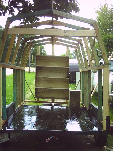

This was the last studded skeleton I built with 2 x 3's 1 1/2 by 2 1/2 actual with 1" x 1" wind bracing let in diagonally. Image
After this the next 2 builds were designed as ultra lights. Rip van winkle was a 4 x 7 build to tow with the Goldwing. It came in at #525 pounds ready to camp. It was a plywood sided build
Image spars were rabbeted and set in pockets the screws were angled up across grain rather than just straight into the end.
Image Yes you now have a wiggly box !

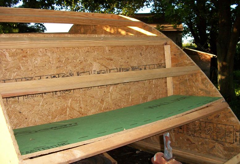

Image Half walls were added to offer stability and reinforcement. By cutting in access holes I was able to create storage shelves
Image These front and rear wall inserts took all the wiggle out of the box
Image The storage shelving was a very welcome addition

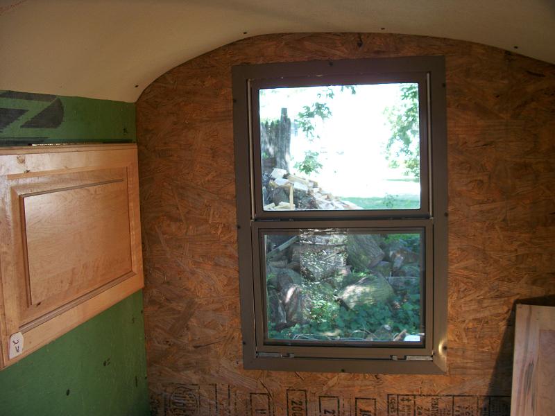

Image Lest you think we left out the creature comforts like insulation I wrapped 1 1/2 blue foam cut to fit with a heavy weight material for good looks and stuffed them into place.

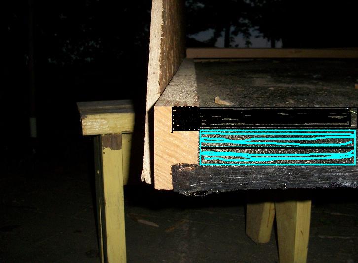

Image the torsion box floor was filled with closed cell insulation and an OSB panel was placed on top for the sub flooring.
