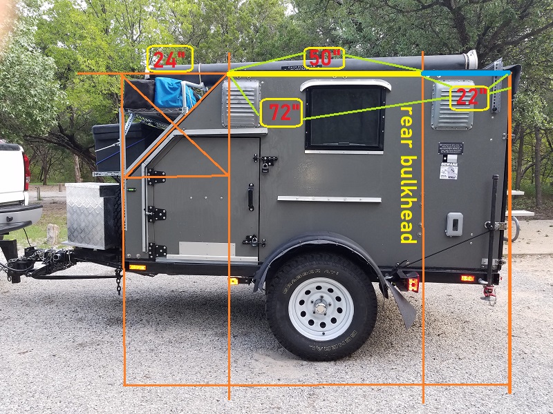

* It's perhaps not the way you're planning to build your trailer, but I built a "simple/squareback" variant, using 3/4" plywood, and steel hardware to bolt it together (plus a lot of PL Premium adhesive). There are no trusses used, just Simpson Strongties gusseted angle brackets and steel corner brackets from Home Depot. Stainless 1/4"-20 carriage bolts, fender washers, and either acorn or nylock nuts were used. The roof, a 48" x 72" piece of 3/4" ply was set on the upper edges of the sidewalls, with the rear inner wall as a cross-support(at 22" from rear, defining the galley compartment).
measuring the roof size, for support calculations.jpg (291.11 KiB) Viewed 5964 times

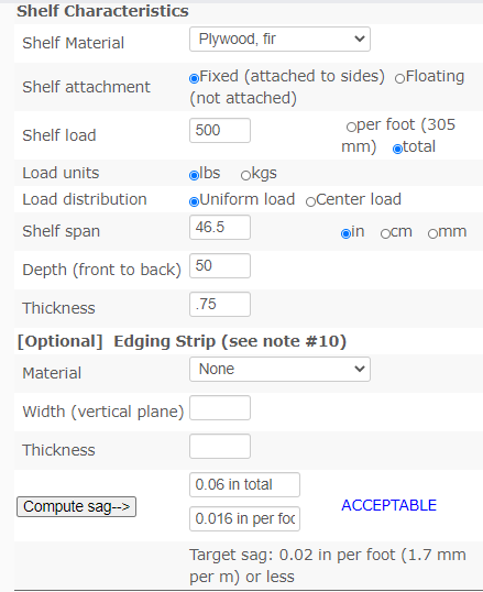

* To use the Sagulator http://www.woodbin.com/calcs/sagulator/, I figure that the un-supported area length between the front slope (which has additional support brackets) and the rear bulkhead is 50", while the roof over the galley/storage area is only 22", and the total width is 46.5" (resting atop the 3/4" (x2) sidewalls), so the maximum area of concern is 46.5" x 50". Treating this area as a "shelf", so to speak, the Sagulator shows acceptable support for a 500 lb. (not centered ) load atop the roof.

* If I had been planning to use a roof-top tent, I probably would've put a roof spar under the center of the 46.5" x 50" area, just for extra safety.

4)* Answered in reply 1. Plus, a single beam/spar located midway between front slope and rear bulkhead will make the sag almost nil.

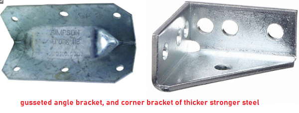

5) * Answered in reply 3; the Simpson StrongTies I used are gusseted and the corner brackets are made with thicker/stronger material to prevent this (the carriage bolts securing these are backed with 1.25" diameter fender washers to prevent pull-thru, while prodigious amounts of PL adhesive further prevent movement on all interfaces).

6)* Use a layer (or two) of sound-deadening material, either on the cabin ceiling, or on top, under the rooftop tent. Good at blocking sound/vibration transmission on cars, this stuff is also (most brands) also waterproof and usually self-adhesive. Dynamat here's one type specifically for decking http://www.dynamat.com/automotive-and-transportation/automotive-restoration/dynadeck/#:~:text=As%20DynaDeck%20is%20completely%20weatherproof,so%20no%20adhesive%20is%20needed.is known for effectiveness, and I've used it before. Here's alternatives compared https://aquietrefuge.com/dynamat-alternatives/
