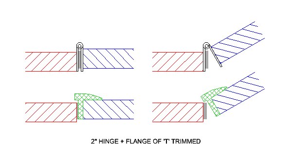

I've been waiting for that question to come up. Well a standard piano hinge won't work the way you want to install it without trimming some of the 'T' molding. Or you could locate the hinge outward at least the dim. of one leg of the T so when you open the door, it will clear. But then the hinge is sticking out at least 1/2 inch. And you will now have interferance at the latch side of the door and will need to do some tricky trimming of the door to correct that interferance.
So then what you may have to do to get the effect that you are looking for is to trim the 'T' molding at the two corners, so as to carry the straight edge of the door at the hinged side. That's the way I would do it. Sorry but my door doesn't have rounded corners at the hinge.

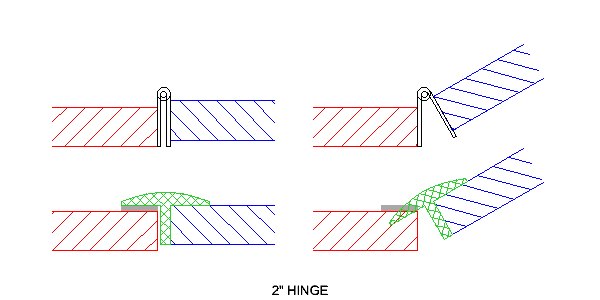

Danny's problem is that the 2" hinge makes one flange of the T-moulding hit the body side as the door is opened:

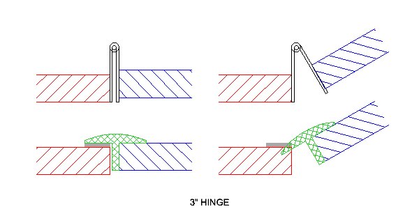

Using a 3" hinge (or any other size) doesn't make the problem go away:

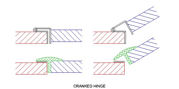

Nitetimes cranked hinge suggestion works, though I hadn't thought about it being weaker:

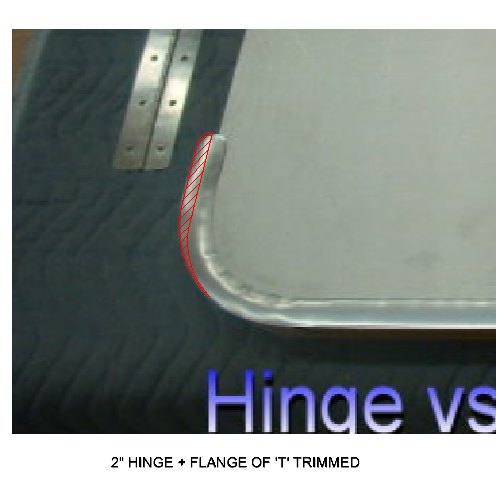

Gage's suggestion about cutting off the forward flange will work (actually not quite all the flange has to get cut off) but there is then a sealing problem. But where the flange has to be cut away, the seal can be switched to inside the door jamb, as the door closes mostly backwards and forwards this near the hinge.
The part of the flange to be cut away is:

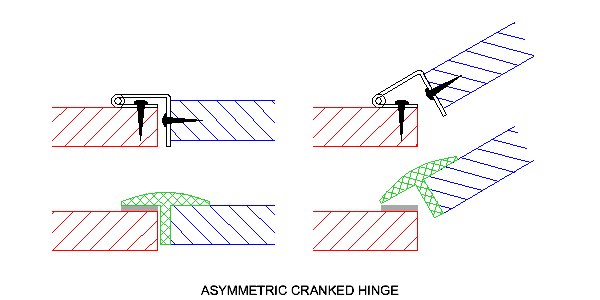

Grant's cranked hinge seems to be made to order, so he could probably make a hinge to suit this job with both cranks facing the same way. As long as the fixed, body half of the hinge were screwed to the body on both its legs, I think the strength would be OK. But of course there's the delay and the cost.

Postby Nitetimes » Sun Feb 26, 2006 2:03 am
Another thought comes to mind while reading Grants post. If you can find someone to bend the hinge they will most likely have a shear available (the 2 tend to go together). When you have them bend the one ear in for the door have them shear the other side down to fit just into the corner of the 90, then redrill it to screw to the outside of the wall. The screws would still be under the other ear so they will be inaccesable thereby preserving your security but eliminating the fitment problem with the thinkness of the heavy hinge.

Postby angib » Sun Feb 26, 2006 7:30 am
Nitetimes wrote:Make sense to anyone but me?
Yup, I was just thinking the same thing as I read your post:
Andrew
