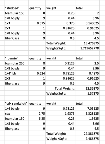

I've been working on a spreadsheet for calculating estimated weights and figured I'd work up a comparison on techniques based on a 3' x 3' section.
The "foamie" assumes a 2x3 top and bottom plate with 1/4" bb stringers. I *think* it's pretty much how the XPStream was built except he used 6oz cloth which would mean more resin required.
Studded assumes 2x3's on top and bottom with 1x3' studs (could use 2x3 studs for a little more weight).
CDX sandwich is Tony's technique here with inner 1.5" cdx cutouts and otherwise filled with foamular then 1/8 bb on either side. Tony generally uses a 3" outer rim I think but it seemed more fair to gauge using the internal sections.
Screen Shot 2021-03-01 at 6.18.14 PM copy.png (51.08 KiB) Viewed 1814 times
Let me know if I got something wrong. Tony's technique seems like it should be lighter so I'm wondering if I went wrong somewhere.
("quantity" is square feet)

Postby tony.latham » Mon Mar 01, 2021 5:37 pm
Here's what I suggest for sandwiched wall construction:
So you may be missing an exterior skin. I like 1/4" over 1/8" for the exterior because of the added meat for holding screw heads.
:thinking:

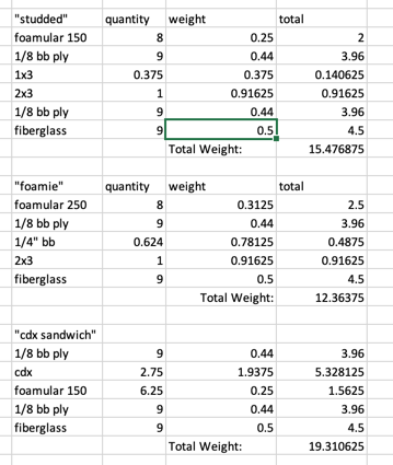

Postby iconicflux » Mon Mar 01, 2021 8:13 pm
Ahh I see where I went wrong there. You have 2" spars/foam for the roof and the walls are 1/4" external and 1/8" internal. Thanks!
Let me redo this and if it looks good I'll modify the original.

tony.latham wrote:Here's what I suggest for sandwiched wall construction:
:thinking:
