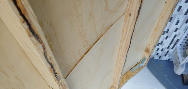

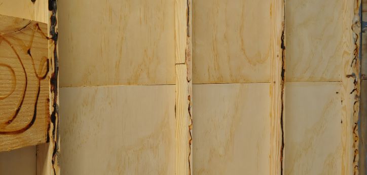

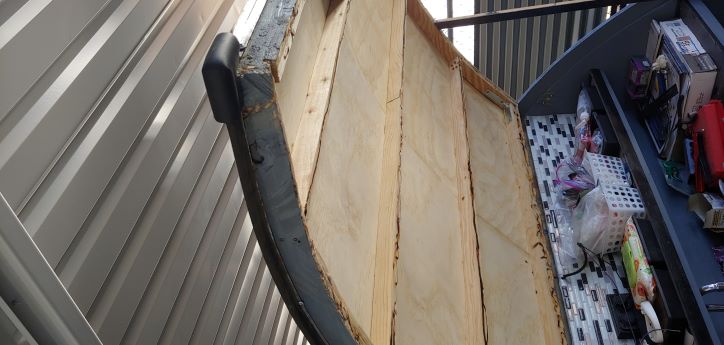

I am revamping my hatch. The struts were stressing the latch and wrecking the wood where they attached. Took those off along with the plywood on the inside. Going to go with poles to hold the hatch up.
The hatch fits much better on the body but now I am getting quite a bit of flex from the hatch. I reinforced the corners with metal angles. I also revealed the builder used 2 pieces of plywood to shape the skin and there is a seam down the middle of the hatch. The formica covers the seam but....:frightened:
I thought I would cut and glue the old plywood back into the cross beam sections of the hatch to reinforce the seam and the hatch as a whole. Hopefully that will lessen the flex too. I do want to leave the cross beams exposed.
Thoughts or other solutions?

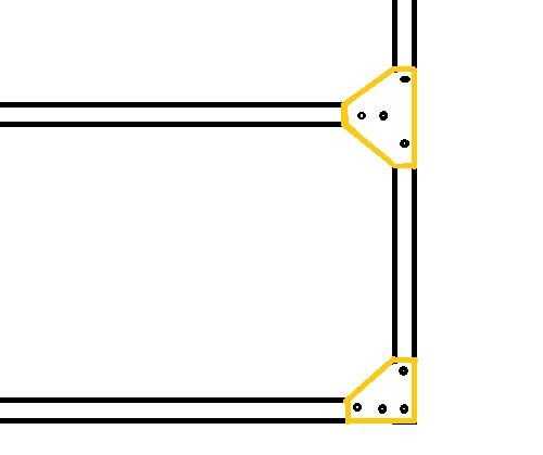

If I did want to make mine more rigid, I would add plywood gussets. In a way, I guess I am talking about putting back just a bit of the inner skin, just where the frame members join.
I drew what I mean in paint. ( One day I'll dedicate the time to learning cad. :) )

Great idea. That should do the trick. I will try it. I know there will still be SOME flex. Just trying to minimize it without putting the inside skin back on.
Also....What about the reinforcement for the seam idea? I suppose I do not need to go the width of the hatch but definitely 4 to 6 inches either way..
I keep looking at the dark brown lines on the cross members. What kinda glue was that? How easy was it to pop the plywood off?

As far as seam reinforcement I think I would go with some 1/8" plywood (or other easily bendy ply) and glue a nice wide patch over the seam. Maybe 6" inches on each side of the seam patch. Lauan comes to mind as it is very flexible. Use what ever size there is room for. Spread glue on the entire surfaces, old ply to new patch, not just a squiggly line. Start with one thickness all the way along the seam. Let them dry well. Put another 1/8" layer on top of that. Maybe slightly smaller. I wouldn't go more than two layers as that section of hatch may cause problems if it is stiff and the rest has some flex. One layer may be all you need.
If you have stiffer plywood for patch material and you are getting initial spring back while the patches are still wet let them partially dry, or start out with contact cement which will grab and hold as soon as it touches the other surface.

No idea on the glue...didnt stick very well either. The deeper I get into the construction, the realization of how shoddy it was made gets more and more apparent.
I have Aluminum gussets going in this week. will update!!

I ended up doing 4 " wide patches of 1/8" hardwood plywood with good amounts of wood glue. Seems OK so far! I am with you on the amount of glue...no time for the zig zags!
