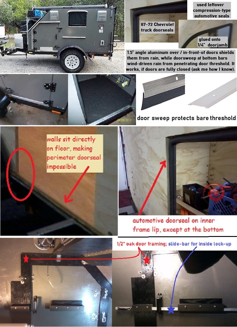

* I used the 3/4" thick cut-outs from the sidewalls as my doors, with no windows or insulation. I made a 1/4" door jamb/stop along the top and side of the added 1/2" thick oak boards, used as a framework/brace for the door and the strengthening hardware added to it. The 1/4" jamb was routed from the 1/2" x 3" wide boards.
* The doors were made to reach to the floor, so no lower jamb was used, instead there's an aluminum threshold that the door slides atop (friction-fit), with no seal, except for an external doorsweep that keeps wind-driven rain out.
* I did use a seal pressed/glued/stapled onto the jamb (everywhere except on the bottom of the door, where there is none). Both right/left seals are leftover from a '69 Chevy truck resto project I did, and never used. Since I used flat gate hinges with no offset (so the cut-out doors would sit flush into the sidewalls they were cut from), I had to remove some material from the layered rubber in order to properly compress the seal upon closing. Still, it requires some force to shut/latch the doors...they're water and dust tight, for sure, that way. I perhaps could trim a little more off, for easier operation, but I'm the only one using the trailer, so....
