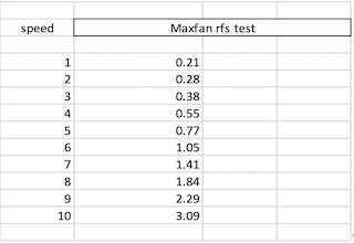

Postby featherliteCT1 » Wed May 26, 2021 6:27 pm
I have Maxxfan. Below summarizes the actual amps drawn at the indicated fan speeds, measured with my shunt based battery monitor.
Screen Shot 2021-05-26 at 8.19.02 PM.jpg (30.2 KiB) Viewed 1295 times

Postby Tom&Shelly » Wed May 26, 2021 9:54 pm
featherliteCT1 wrote:I have Maxxfan. Below summarizes the actual amps drawn at the indicated fan speeds, measured with my shunt based battery monitor.
Mine are similar (measured with a DC clamp-on ammeter):
0.05 A
0.15
0.2
0.4
0.5
0.7
1.0
1.35
1.80
2.65
It's a no-frills MaxxFan--no temperature or rain sensor.
After two spring trips in New Mexico and Arizona, I think we only ran it for a few minutes one night on one of the lower settings. The roof vent is the main thing.

Postby featherliteCT1 » Thu May 27, 2021 5:23 pm
My fan is also a no-frills MaxxFan--no temperature or rain sensor. In my setup, I consider it to be a relatively high amp draw item.
