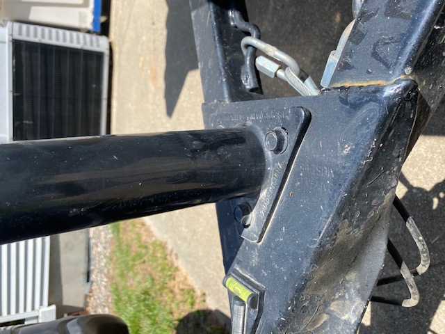

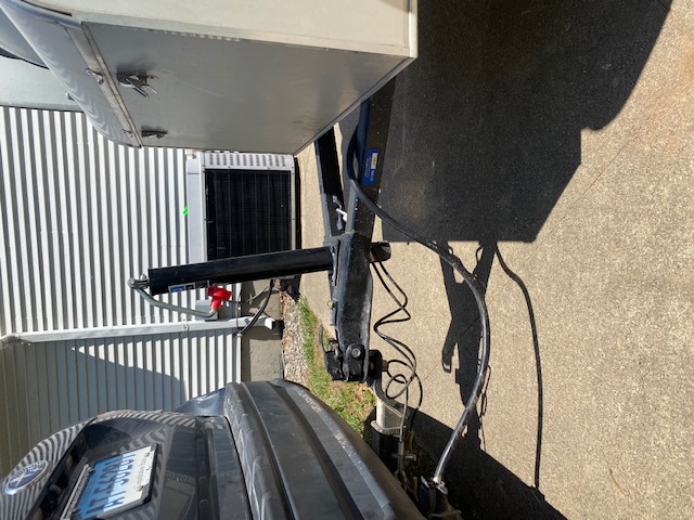

I used a trailer jack that mounted in the V portion of the frame, it worked OK but required a lot of winding to get it up out of the way so it doesn't hit rocks when on bad trails. As you can see the jack is angled forward because of getting abused.
The jack was fine the hitch mount actually took the damage (it bent a little)

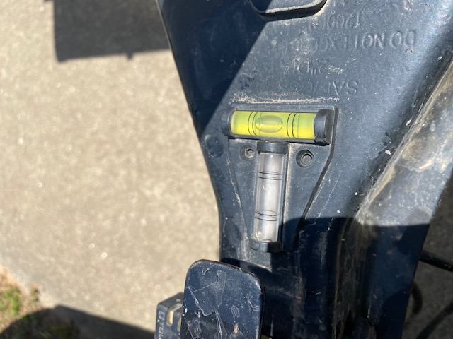

Minor casualty, one of the levelling bubbles died.

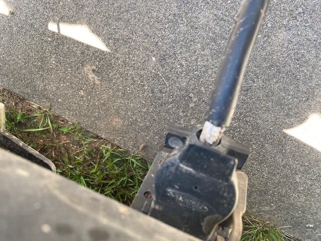

7pin connector jacket pulled out of connector.

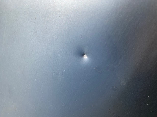

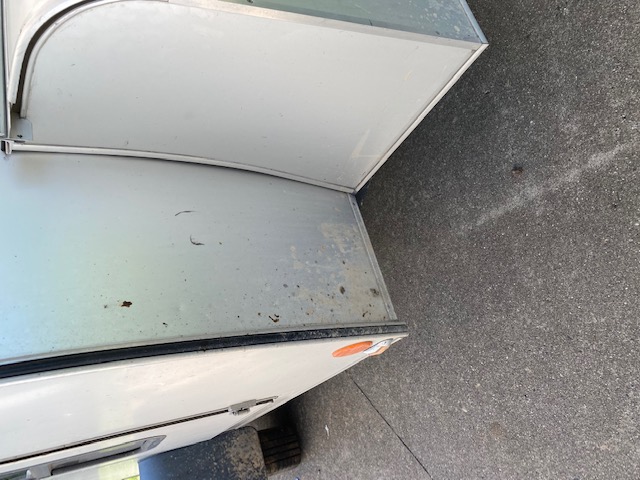

This ding was from when my son removed the tool box cover when fixing the electrical issues.

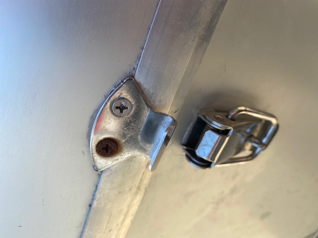

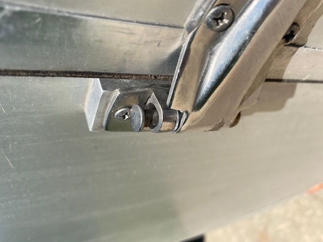

I guess I slipped one Zinc screw in my SS box.

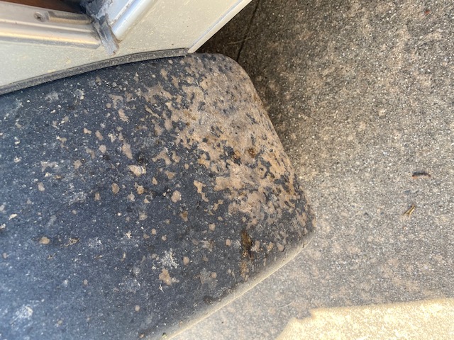

I made my own fenders from wood and fiberglass, they held up great however the Raptor liner was sand blasted off from driving too fast on the dirt roads.

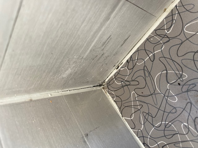

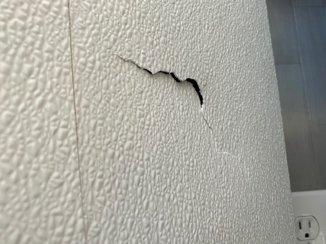

I had some minor cracking between the counter and the side walls in the kitchen area. Incidentally the aluminum back splash is great. It cleans up super easy with a scotch brite pad.

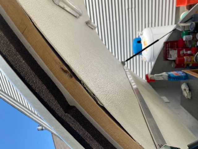

I had some damage to the headliner in the hatch area, It was closed on some tall items that didn't quite fit.
The headliner construction adhesive failed and I have a little separation from the spars.

to solve your tongue jack hitting/bottoming out - check out the "Ultimate Tongue Jack" brand tongue jack = I like mine.... the crank up/down shaft is 'adjustable', it has 15 inches of crank adjustment and another 12 inches of being able to slide the shaft up/down in 2inch increments for you to decide a starting crank point along with being able to slide the whole shaft up after use for parking it up away from the road when traveling = No more bottoming out!! (also when parked and access is needed into the back of the tow vehicle, you may be able to drop the shaft down to the ground thus gaining room for the opening of your tailgate above it or in my case, dropping my PU tailgate down for more clearance.) It bolts/mounts right into the 3 bolt triangle set-up you have and has a 2000lb weight rating. E-trailer sells them or Tractor Supply carrys them in stock if you would interested in looking at one.(about the same $$ either place)

I used a trailer jack that mounted in the V portion of the frame...
On my first build, I had a similar jack that I raised up about 3" using longer bolts and 3" pieces of pipe.
