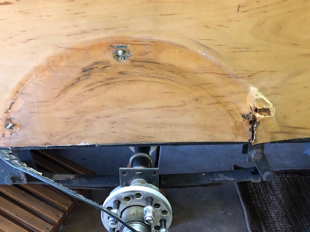

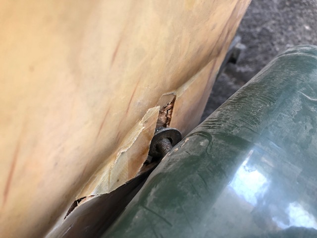

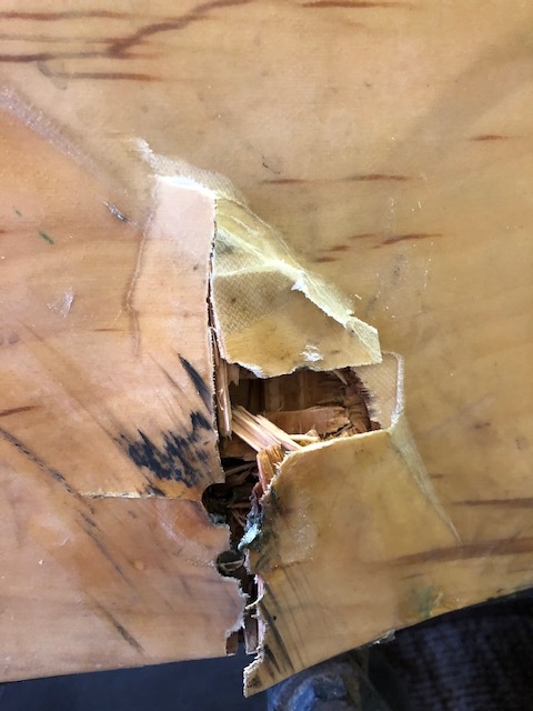

So, first major damage to our 12-year-old woody. Coming home from camping today on a very rutted, rocky road, managed to pull a fender bolt all the way out of the wall of the tear. It is 3/4" solid birch plywood walls with multiple coats of epoxy followed by 4 coats of spar varnish. We will be doing the repair, as we figure since we built the thing, we can repair it. Looking for any suggestions and ideas on how to repair this awful, making me cry damage. Image Image Image

I would set up a router with a plunge base & inlay a solid block into the bad area (3/4" plywood shaped to fit). After that, set it with epoxy to glue it in the hole, then re-glass the bad spot & refinish it. It will take a bit of time, but the bad spot is inside the fender, so no biggie once it's glassed & re-finished.

I would do a stepped repair. It would take longer but be a lot stronger that just cutting out and replace. What I would do would be to cut the bad area out squarish with rounded corners. Then take a router and route out half way thru the surface about 2 or 3 inches out from the edge. Even better would be to do this on the inside but that would be a lot harder. Then I would take the "patch" that is cut to the size of the routed area and rout it to fit. So basically creating a scarf joint all the way around the patch, this gives you 2 or 3 inches of glue joint all the way around.
The re finish to match the rest of the trailer, then find a way to plate the inside bolt to stop it from happening again.

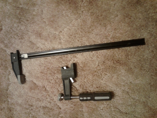

Danny's suggestion of a clamp gave me an idea. It's a little easier than using a long clamp and uses an easily plugged hole or two to let you use a small clamp. Grab one or more of this type of clamp. This is just a cheap Harbor Freight model.
Grind the retainer button off the end so the clamp will come apart.
Now drill a strategically placed hole or holes (3/4" for this clamp) to run the end of the clamp through the wall and reattach the clamp screw end. With a backup piece of plywood or plate steel you will be able to squeeze the wound. Add your epoxy or other repair material between waxed paper and the wound will come out nice and flat and ready to sand smooth. Plug the hole you drilled with the appropriate wood dowel.
Ideally the hole you drill will be hidden in the wheel well below the fender. More than one clamp may be required to get the compression pressure you need. I hope you can follow this thought.
