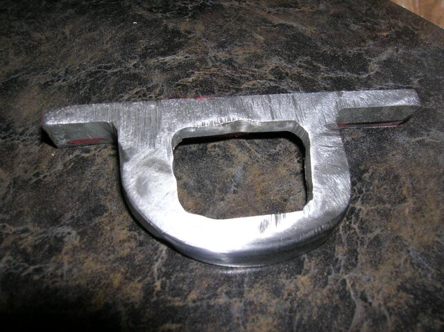

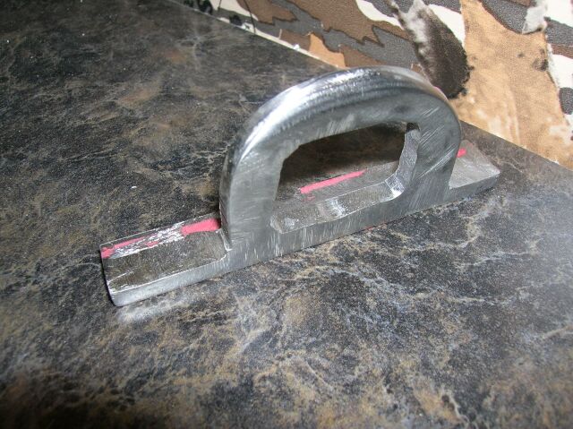

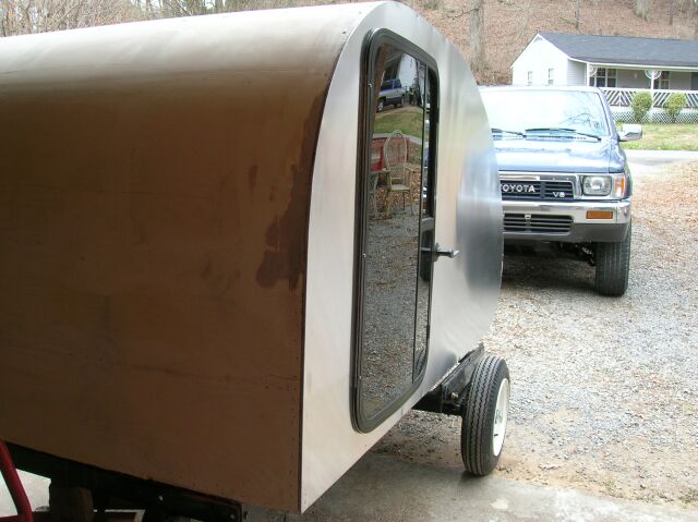

We got our doors hung and the latches on today. I had to make the strikers out of angle iron but they look pretty good. It took a lot of drilling and grinding to get the angle down to look like a real stricker. Tomorrow, hopefully, we will get back on the cabinets inside.

Kirtsjc, we got them at an auto salvage yard. They are side windows from a damaged conversion van and for $35 each we couldn't pass that up. You do have to do a little modifying to make them work but it isn't too bad. You also get the trim frame with the windows and they have a sliding window with a screen also. If you decide to go this route, be sure to pick windows that are not curved. These have about 1/4 curve in them but we have that worked out so it will not be seen, and they won't leak, I hope.

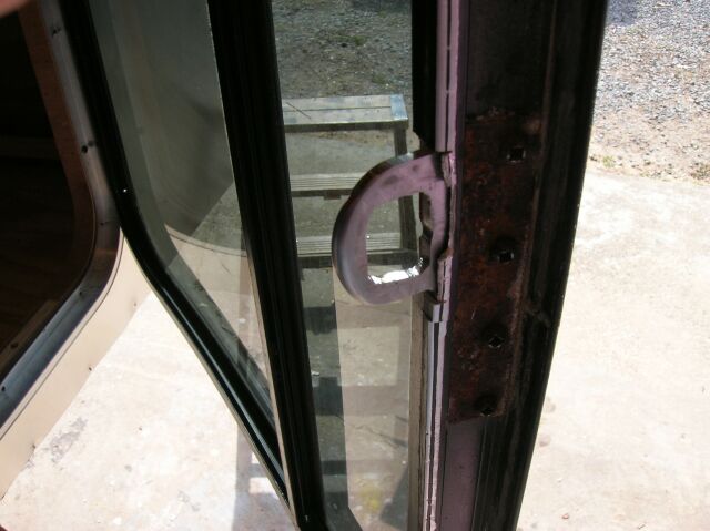

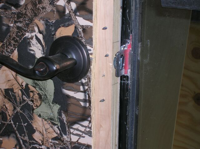

Larry, I will take a few pictures today of the works of the doors and post them tonight. I used a SS paino hinge and will wrap the hinge with a bicycle intertube to water proof. The door being black, you will not notice the intertube. Even if there is no tube on you can not see the hinge unless you put your head against the tear. That is a regular house door knob/lock. I turned the barrel backwards and made the striker out of angle iron. I still have to do some dressing the striker area up but at least you will be able to see how we did it.

Larry, here are some pics of the striker and door latch. I haven't completely finished dressing them out yet but hopeful this will give you the gist of it. I hope this helps. If I can help further, just let me know.
