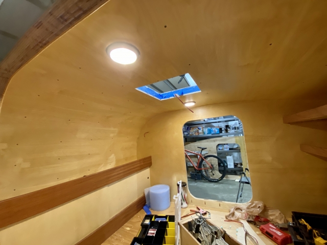

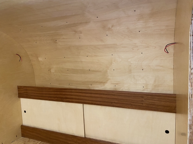

Postby GarthB » Wed Jul 28, 2021 7:49 am
Personally, I didn't love the idea of seeing holes or staples either. However, without anything, I assumed the PL premium would expand and push the headliner away from the bottom of the spars as it was expanding/curing.
I ended up using some 3/4" painted finish screws instead. Before installing the spars, I chalk lined where each spar would lie on the top side of the headliner. I then measured out and predrilled holes so that I would have five screws spaced evenly across each spar. Once a spar was fastened to the wall lip from the outside of the camper, I screwed into each spar from inside the camper at the predrilled holes.
I was skeptical about how it would look, but my wife and I both liked the end result. They're more noticeable in the photos than they are in person. I used the same method on the interior side of the hatch, but with stainless screws.

As you may know, I use a 1/4" crown stapler (+ PL Premium) to attach the headliner to the spars. You can see them but they aren't very noticeable.
It helps to set them in line with the spars and do them in rows instead of randomly. I don't have a really good photo but these will give you a sense of what it looks like. You can see two above the Propex thermostat.
You might varnish a test piece of Baltic and lay a couple of staples in it and see what you think. :thinking:
