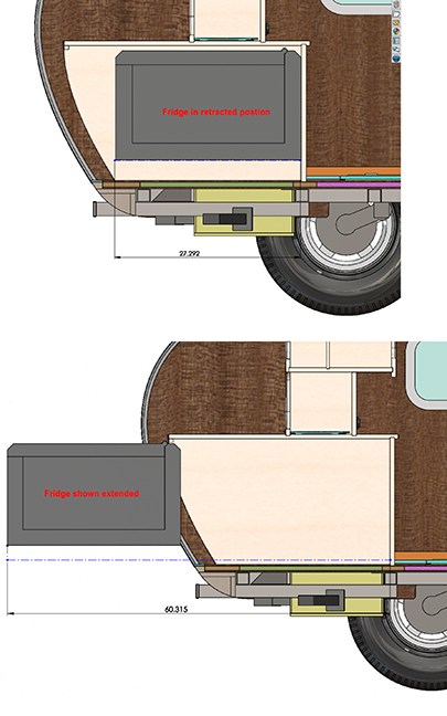

The fridge I'm using is about 27 inches long and the way I have it planned I'll need for it to be able to be pulled out it's entire length (due to where the hinge is on the fridge lid).
I've attached a section view of the layout.
I'm asking if anyone has any suggestions on what kind of drawer slides to consider. I "think" I've seen slides that come in 3 sections to handle long pulls, but not sure that is what's needed.
Any suggestions what is needed and where to look?
thanks
John

After a bit more research I think I do need a 3 section slide for such a long pull.

Check your design for a decision on the bottom-mount vs. side mount guides. You will need to attach to the fridge, but will it be a box or platform type of system. A 30" full-extension slide will typically give you 31" of travel. Here's a side-mount guide that would work well enough.
https://www.cabinetparts.com/p/knape-an ... non-brands)&utm_term=4585100930997398&utm_content=All%20Products
For our stove, I added 2 aluminum angles to the bottom/sides of the stove, then attached the guides to the side flange of the angle. Works OK for the stove. Your fridge should be a similar type of mount, depending on the design you come up with for having the fridge sit in the opening. Here's a detail shot of the angle, guide & latch to lock things in place on the road.

Tim, that looks great! Thanks for responding to my post with this. I looked on that site and found an installation video. I'm thinking I'll most likely build a platform for the fridge to sit on and mate that platform with the drawer slides. I just need to figure out if bottom mount or side mount will be best, although I don't think I have enough space for side mount and will most likely go with bottom mount.

I use KV 8400 series full extension soft close slides.
The drawers stay in place when starting and stopping while traveling.
It’s really nice how they pull the drawer to the cabinet face the last inch of travel.
We even have them in the house kitchen.
Another of KV’s glides are push to open, push to close where no hardware needs to be on the drawer front.
I use them on furniture but they would hold a galley drawer in place.
I use a barrel bolt to hold our Camp Chef stove in while traveling and when it’s in use.
