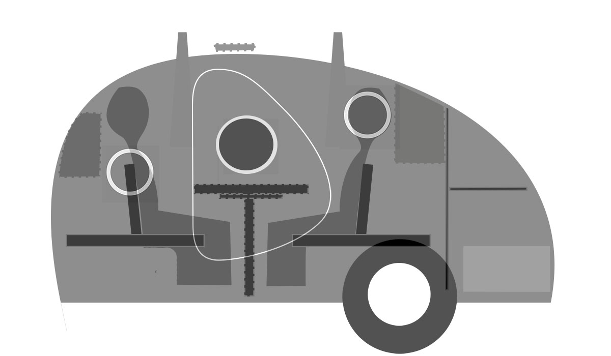

I'm attaching my recent photos of the templates which are ready, and the design. Please feel free to post suggestions of potential issues which I may encounter.

One thing I would look at with your design would be the lower edge of the cabin entry doors. It might be better to have a flat bottom on the door. It would be easier to get in and out if it's level with the frame. Otherwise, it looks like it's pretty narrow in the lower corner & might grab a foot on the way in or out. I like the basic shape of the side panel & profile. All of these little design things to look into...
137905
noseoil
Posts: 1822
Images: 670
Re: Okoume wood vs Baltic Birch
Postby KCStudly » Mon Sep 20, 2021 12:07 pm
What noseoil said about the shape of your door bottoms x2.
Picture yourself sitting down fanny first into the doorway, taking your shoes off, then leaning back, pulling your knees up and rolling you feet back in past the aft door jamb.
Now picture yourself reversing that process. Now sitting in the doorway, a little groggy after waking up. You're going to want to sit there a minute or two (or longer, taking in the scenery) before you put your shoes on. You don't want the sill to be digging into the backs of your legs, and you don't want to whack your feet everytime you swing in or out.

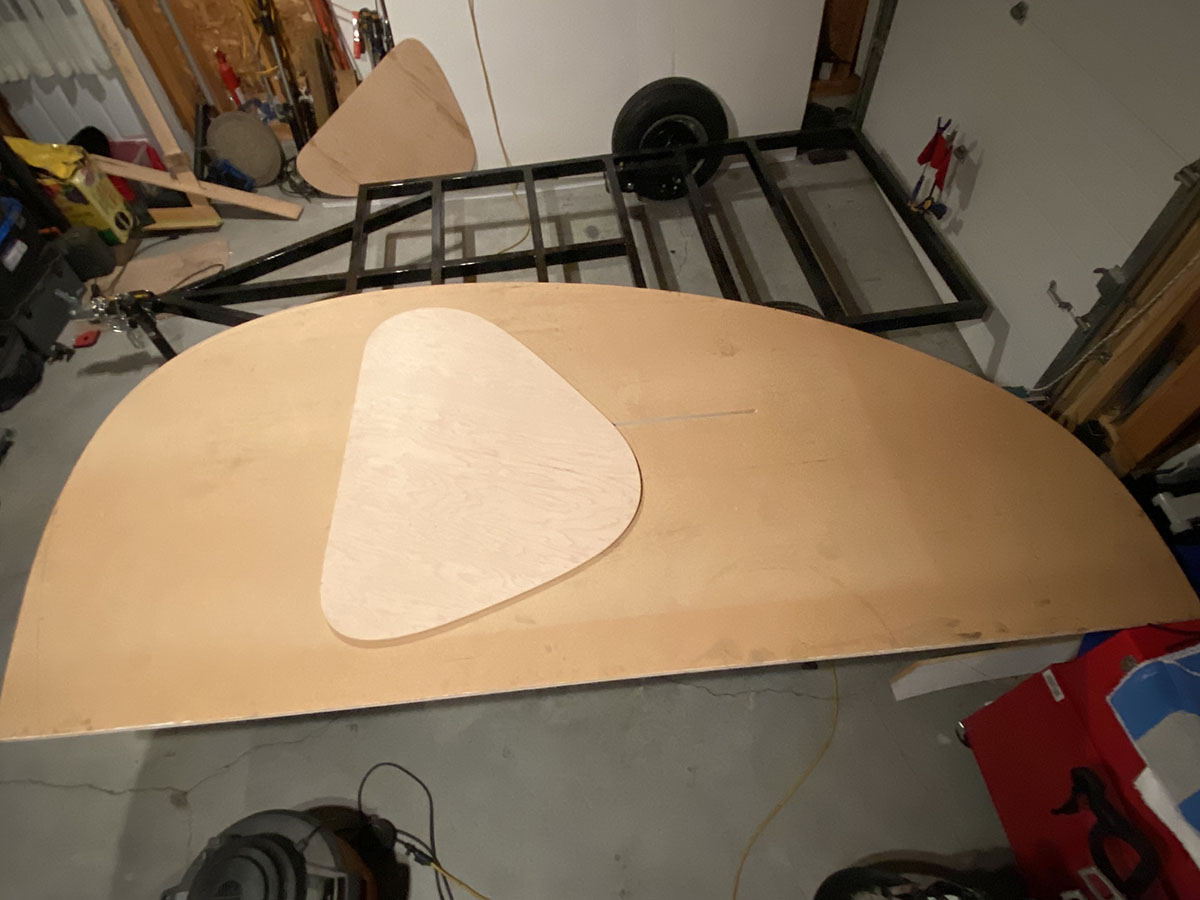

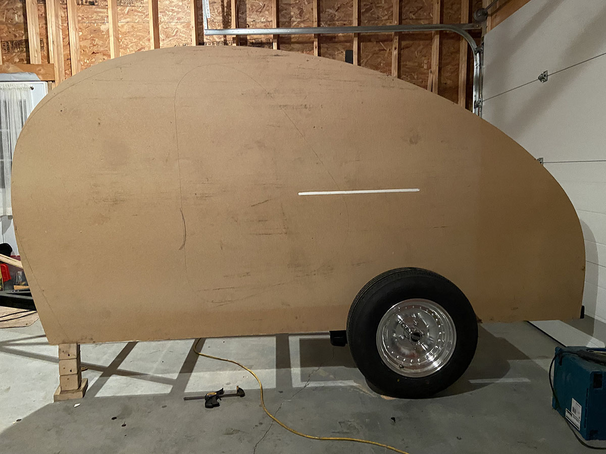

I was able to figure out the router bits issues finally! I had a 3/4"+ sheet of heavy 5X10 particle board hanging around. So I used it to make a template. Then I routered along edge with a combination of guide bushings and ball bearings. My ball bearing bit needed to be the final pass. I had to start with guide bushings so I could make a few shallow cuts instead of a deep haul. (I tried the deep haul - not an easy thing to do)
After all the back and forth to the northern lumber and hardware shops (limited selection) I made a sample of the doors. I started with a template and cut out a one inch wide rabbet and then flush cut with the 1/4" spiral upcut - So essentially I end up with a 3/4" rabbeted edge for the door seals.
It is gratifying to have the walls shaped and positioned on the floor to get a "real world" sense of what it will be like - no roof yet - but it's still cool.
The door has been cut out of my template. I had it standing on the floor and it was much larger than I expected - 49" tall X 34" at the widest point.
The door is unique - thats for sure. The bottom of the door is going to be considerably lower than the mattress. And that's because the mattress is elevated - imagine having one foot of "crawl space" (for lack of a proper term) under the bed for storage of photo gear - large heavy lighting stands mostly. Two 1 ft X 1ft wide stand drawers run the length of the interior from front to kitchen bulkhead. (over 6ft in length) They are positioned at the sides - and they will pull out through the rear kitchen area.
So this stand case will be the lowest entry point - even though the door dips lower - it will have a flat comfy entry (about 30 inches in width). And there will still be 3ft width of open area for foot room when the mattress is converted into a couple of facing couches between the stand cases. When the bed is in couch mode you would need to sit on the stand case and stick you feet out. So it should still be an easy in/out. Enter on your knees and exit on yer butt.
I hope it is as easy as I want it to be - it will be approx 30 inches from ground to top of mattress.

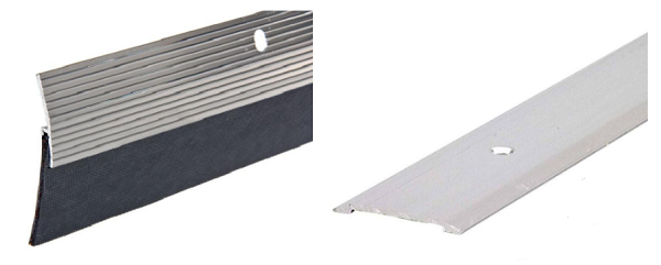

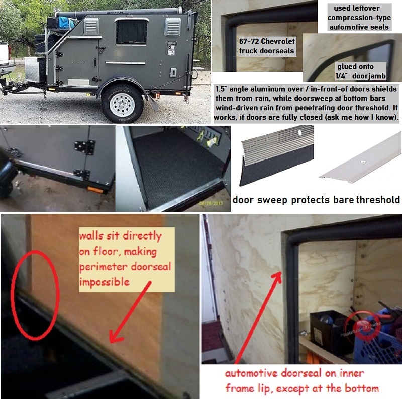

grr8 wrote:Is it necessary to use aluminum trim around the perimeter of the home built wooden door if it is sealed with fibreglass? I am using rubber doorstop bumper seals and I would love to find a lap seal for the outside gap between door and wall....
* I used the raised curve of the aluminum threshold to create a slight friction-fit with the door, and use a stiff vinyl door sweep to create on overhang to seal off the threshold/door from water being blown in, or thru surface tension. My 3/4' thick floor sits on the trailer frame, and the sweep overhangs it by 5/8", leaving an 1/8" gap above the steel frame (the 48" wide floor/deck is centered on the 50" wide trailer frame, so 1" of frame is exposed, preventing further overhang depth).
w/o a rubber seal at bottom; a "friction fit" atop alum. threshold and a door sweep to shed water
door sweep and threshold.PNG (111.45 KiB) Viewed 1195 times
* For the upper part of the door, I made a 1/4" stop/jamb (of 3" wide oak lumber) surrounding/bracing it, and used '67-'72 Chevy truck doorseals attached to it. Because I didn't use offset hinges, and the seals were very thick, I trimmed about 1/2" of rubber from the inside curve of each in order to achieve a flush (but very tight) compression seal.
doorseals and water protection (2).jpg (249.23 KiB) Viewed 1195 times
