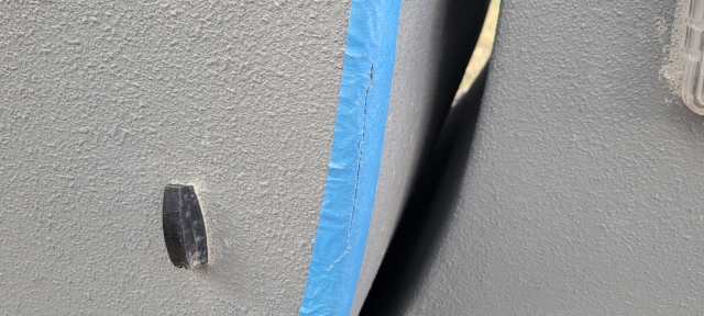

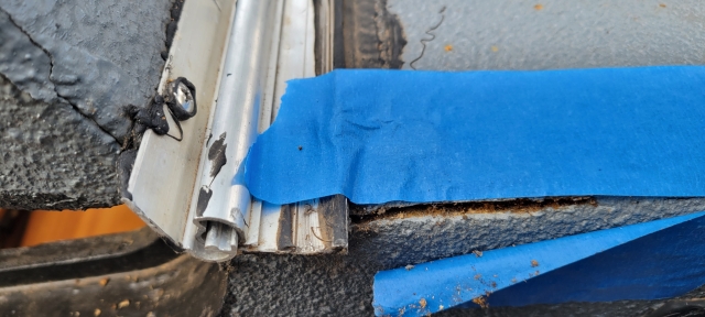

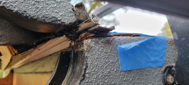

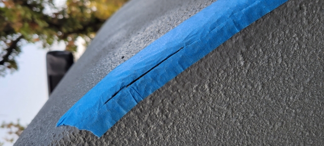

When I built my teardrop I fiberglassed the exterior and then sprayed it with bedliner.
Where I used a round over bit on the edges is starting to crack. I have gotten some water damage in the galley that is delaminating the plywood some.

Postby saltydawg » Mon Sep 13, 2021 1:44 pm
My answer is grind it out. Yes I mean the ply, the glass the bed liner. Take it until you have solid wood, then start adding layers of glass and resin until its back close to there it needs to be. Then fill with epoxy and micro balloons and epoxy, then refinish with the bed liner.
Anything else will take almost as long and not really fix it, just being a bandaid is not good enough.

Postby GarthB » Tue Sep 14, 2021 9:05 am
I'd follow Scott's approach, mentioned above. Fiberglass tape is going to solidify the joint and prevent it from any additional movement or separation. It'll be a good bit of work, but I'd bet that it would be the longest term solution and best bet at preventing any additional water intrusion. The painters tape shown in my photo was a technique used to make fairing the tape edge into the surrounding glass a little easier.
