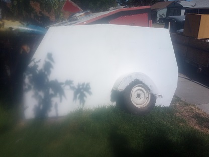

We used 5 ft by 5 ft sheets of 1/8 inch and 1/4 inch Baltic birch that cost around $20/sheet three years ago. I imagine the price has gone up, but I hope not that much :worship:
This stuff is not marine grade, and you have to find a lumber yard that carries it or will order it. Tony Latham, on this forum, has tested the material by putting pieces in water with good results. We fiberglassed our exterior and have not had any problems so far (after six months of use and sitting outdoors in a rainy climate).
Full story is: Our wall interiors are 1/8 inch bb, the core is hogged out 3/4 inch AC plywood and foam insulation, and the exterior is 1/4 inch bb covered with 6 oz fiberglass/epoxy, primed and painted with bedliner. Roof is similar except the exterior is only 1/8 inch bb.
