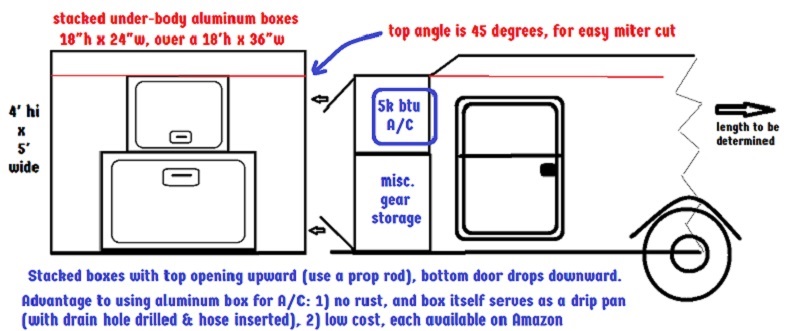

* I use an LG model LW5012J A/C in my squareback 4x8 trailer, mounted in the wall between the galley and sleeping area. It uses a right-angle powered ducting system so that it is able to run at night with the hatch door closed & locked. I considered moving it to the front of my next (if ever) trailer, so that more room would be freed-up for galley, or an enclosed porta- potty area at the rear. As-is, the A/C unit (without the area taken up by the ducting and drip-pan/stand) is only 17 5/16" W x 11 5/32" H x 12 27/32"D, and only weighs 37.5 lbs (easily supported on the 3/4" plywood wall, with 1/2" oak framework), so it could just as easily be permanently-mounted in an enclosed aluminum box on the front wall (my current trailer's front wall is too short/sloped).
* I made a drawing/plan for using aluminum truck "underbody" boxes to house the A/C on the front wall, providing a way to cover it between uses, and seal it away from pests and/or road damage. If the minimum box size shown is used, then the A/C might need side vents mounted for chassis cooling while running, or maybe not; the opened door will allow enough exhaust venting, for sure.

Postby Onajourney » Wed Sep 29, 2021 12:52 pm
This AC layout is GREAT!! Lifting it for sure. Thanks
