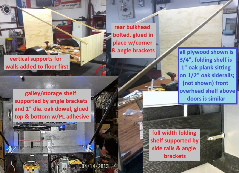

* I believe in strength and durability, so I braced and reinforced the basic structure as much as I could, by firmly attaching front wall & rear bulkhead with bolted-on steel corner & angle brackets (and all interfaces glued between, inside and outside with PL adhesive) before affixing the front slope, roof, & walls (in the same manner). In the same vein, I used full-width shelves (two of 3/4" plywood: galley and front overhead; one of 1" oak planking: the rear folding shelf inside the cabin), sitting on 1/2" oak side rails, steel brackets, or on both. And glued, too. All plywood used was 3/4", so no flexing, bowing, or bending is likely.
so much bracing before roof placed on top.jpg (218.75 KiB) Viewed 889 times

I believe in making things as light as possible.. but maybe I will be converted to your way of thinking later. After trying to build something, which I have not yet. Of my worry I'm 99% worried about moisture, 1% worried about strength, based on what I've seen kill campers.

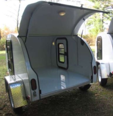

What I meant by "adding a couple shelves" is two L-shaped full width overhead shelves to reinforce the deal in the original post. I bet you that would fix it. Not actually having seen it, pure conjecture. Or even the one twisted lines posted with the totally open floorplan there. I bet a couple of overhead full cabin width L-shape shelves would strengthen that up considerably. Probably wouldn't even need to be that long or tall.

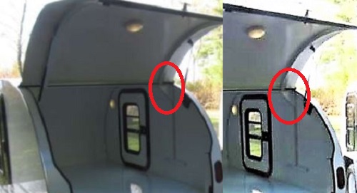

That opened up one is commercially made in the under 30K post, and is reinforced with angle's near the top ;)

twisted lines wrote:That opened up one is commercially made in the under 30K post, and is reinforced with angle's near the top ;)
* Yeah, I see that brace now. But why not make the trailer a bit longer, and still use a bulkhead wall separating "toys/gear" from sleeping space. As much as I loved my project cars, I never slept with them.
