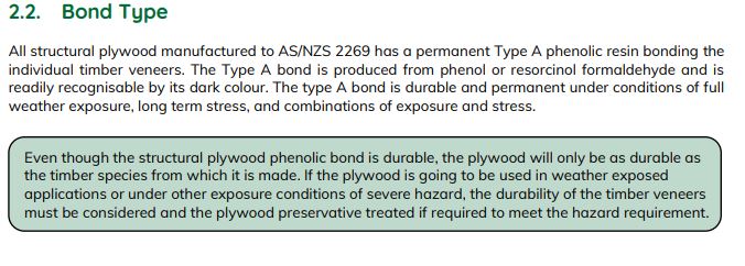

Tony, the following comes from a Australian timber supplier's website:
"Plywood Manufacture
Four types of glue bonds are used for plywood manufacture, in decreasing order of durability.
Type A bond uses a phenol-formaldehyde resin which is specified for marine and exterior plywood and will not weaken under wet conditions, heat, or cold."
"Structural Plywood
Structural Plywood is suitable for structural applications as a Type A bond is used."
This below comes from the Engineered Wood Products Association of Australia:
I look though. I want to see that dark glue line, and if it's the real deal, it has the stamp on the back saying what the glue is, and what standard it conforms to,
I believe there has been imported substandard plywoods that failed.
MickinOz

Postby MickinOz » Sun Oct 31, 2021 11:42 am
So, in theory at least, the same glue is used in both marine and structural plywood. So they say.
I always read the fine print on the back of the sheet.
However, I have definitely seen prior mention of this issue that edge has raised, on this forum I think.
I reckon it was about the glues being changed to less toxic materials and this resulting in lesser solvent resistance.
I always check - I have to see that dark brown, almost black, glue line and I have to see A-Bond or WBP printed on it.
