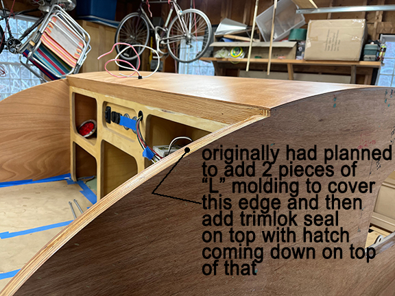

I've been working on the final layout for the hatch. With that I'm trying to determine the sealing and aluminum trim for not only the hatch and galley area but also for all the corners for the entire trailer cabin, as it all seems to tie into one another. Sheathing the sides and roof with .040 aluminum. I had originally cut out a 3/8" inch recess on the trailer's sides for a strip of trimlok for the hatch to land on, but not sure I'll be following that original design (pic attached just below).

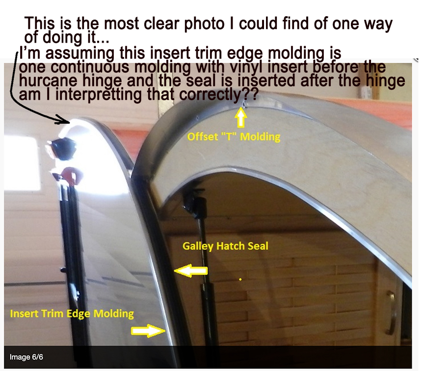

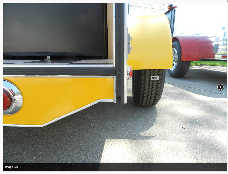

I'm planning on using the wide offset "T" aluminum molding from Vintage Technologies on the 3 side edges of the hatch to land on a seal of some sort but I'm having trouble envisioning how the other corner moldings tie into that, like on the other side of the hurricane hinge. In "web searching" I can see on other trailers there seems to be a continuous molding channel filled with the vinyl insert but I can't see how the hatch door lands on top of that to create a seal, unable to find some close up shots of how all this comes together (with the acceptation of the attached from Vintage Technologies). I'm wondering if the continuous molding I see has the vinyl insert until it hits the hurricane hinge and then under the hatch edge rather than the vinyl strip a trimlok seal is inserted into the alum molding rather than the vinyl insert (in that same aluminum molding??).
So.... I'm asking if members could post some various pictures of their aluminum moldings and also especially the areas around the hatch and where the hatch lands on the seal (like before the hurricane hinge and after the hinge. Any other more detailed photos would be a big help.

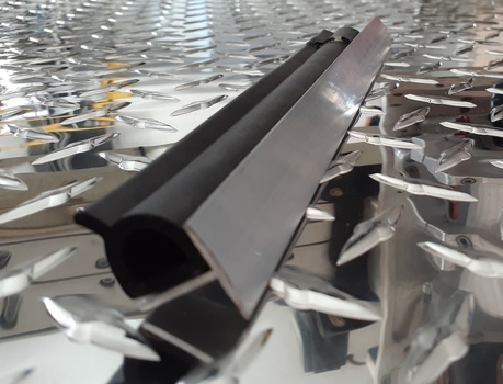

Here is the left over 10" of T,
and a seam I got in the Q seal all stuck together

John, like anything there are numerous ways to do things.
I learned on this forum to use RV insert molding the full length of the corner of the walls and galley hatch.
Where you have roll pans you may need to anneal the aluminum and possibly dish out the edge to make tight turns like I have done.
I use Chicago Screws to attach it to the galley lid.
The Vinyl Insert Trim Molding will shrink in length so I use end caps to hold it in place and it looks finished that way too.
I use the galley hatch seal under the lid overhang like is on Vintage technologies website.
And a "D" seal to seal that 1/4" gap between the lid and inner wall.

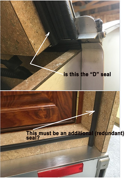

Danny, I was looking through some screen shots I had of your trailer.... attached is one that seems to make it clear how you do your seals. Do I have the labeling correct on the attached image...regarding the D seal and the second seal on the side wall?

Postby halfdome, Danny » Sat Dec 04, 2021 10:17 pm
Capebuild wrote:Thanks TwistedLines and Danny for your help. Appreciate it.
Thanks very much again. Slowly trying to figure this out and what will work for my trailer.
John
Yes you do John.
Here's a better view of those additional seals.
I use "T" molding on the bottom of the galley lid with the ribbed seal.
