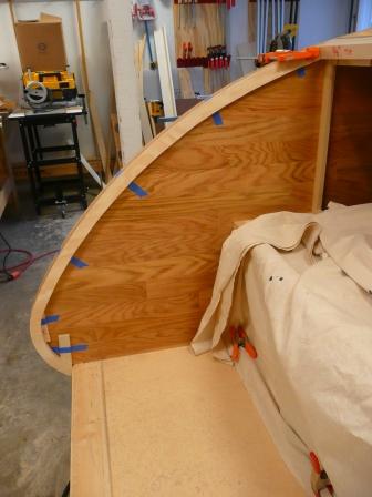

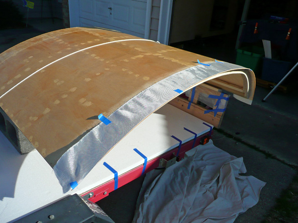

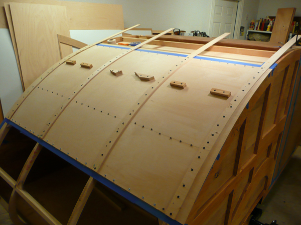

Because I had not installed the sidewall aluminum, I constructed my hatch framing using temporary "through screws" from the sidewall, through 1/4" spacers, and into the outside plywood ribs. I then applied the 1/8" (3mm) skin with the hatch framing "in place". The plywood was run "wild" past the edges and then I used a trim router to later cut it to width. After time for adhesive cure, I removed the temporary clamp screws and filled the screw holes. I then removed the temporary through screws, removed the hatch, applied fiberglass tape along the overhanging plywood edges for reinforcement, and epoxied the entire outer 3mm plywood. (I used two coats of epoxy on all plywood "skins" before adding the aluminum.) Although I didn't have spring-back, even with the tight bottom profile radius and narrow plywood ribs, you may want to install temporary diagonal framing, attached at the bottom and top of the ribs, to "fix" the hatch profile. (The blue screws and straps were applied temporarily to "clamp" the plywood to hatch framing.)
(I'm not sure why this image is rotated or know how to fix it.)
