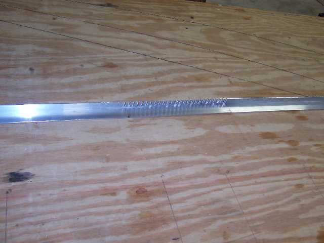

...spent the whole day annealing and bending Al trim of various sorts, and thought I would pass on a couple of tips... I use the candle soot and yellow flame method, I find the combination to work well for me...when sooting the Al, all you need is a VERY LIGHT COAT of soot...a heavy coat will cause you to over heat the Al, causing discoloration if not melting...that is what happened in this pic...both pieces are annealed;

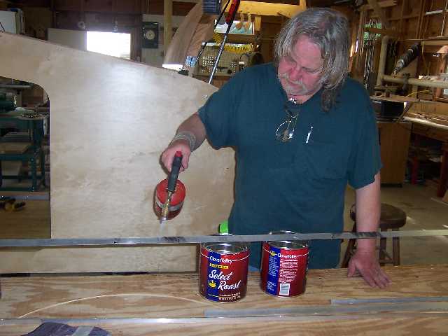

...in this pic, notice that the piece I am working is not completely sooted. I only sooted/annealed those sections that were in the radiused corners of the doors...the area I am working on is 2/3rd done...a slow steady hand is needed and dont let the flame sit on any one spot...keep it moving;

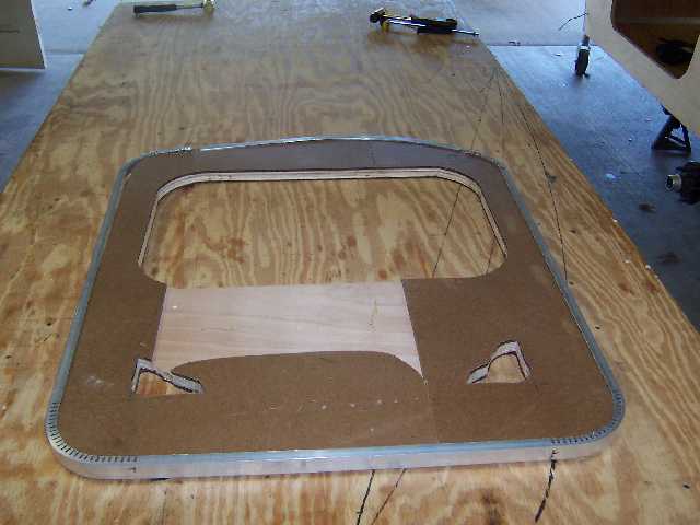

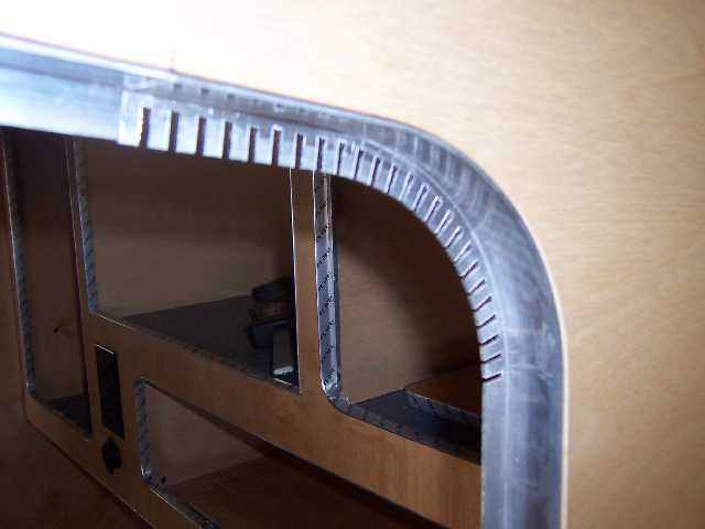

after annealing the piece was kerfed to help it bend into a 4" radius...we used a form to bend the AL;

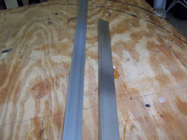

two pieces of 1x1/2 angle were used to make the door jambs...the inside is mill finished and will have a trim seal on it for weathproofing and the outside is anodized

What are those two triangular shaped holes in the lower area of your door?
Guest
Postby madjack » Thu Mar 02, 2006 2:31 am
...first off, that is not a door(now) it is a bending form and the two triangular holes are places for clamps to grip

Hey MadJack- wondering what type of aluminum trim you used on the cabin cabinets? Looks like you routed them and then covered the raw edges with a thin aluminum...can't tell from the pics, but is it just an edge cover, or is it a T shape that will act as a door stike all the way around. I am thinking about trying to find a rubber T-shape or H-shape trim that can just be pressed around the routed opening and provide: (1) a door strike, (2) draft stop (especially for the cabinets that lead into the uninsulated tongue box, and (3) avoid having to do a bunch of annealing for all that small radius trim in the cabin and galley....seen anything that might fit the bill?

Postby madjack » Fri Mar 03, 2006 5:24 pm
greasy, that is not aluminum, it is a plastic "T" molding with an alunmized finsh that was inserted into a slot routed into the center of the openning...we got it from Outwater Plastics thru a local cabinet shop...it comes in many colors and sizes...for stops we cut 1/2 Al angle to the appropriate size....all the doors and cabinet framing were done with this in mind so it works out on the money...
