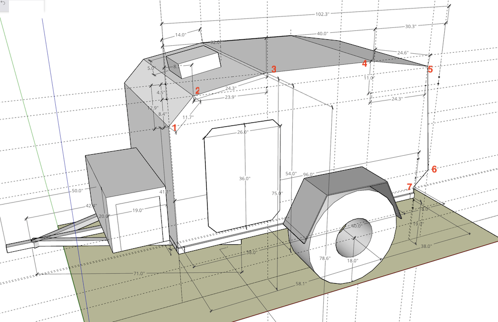

Thank you so much for your response John! I managed to get the 5x10' 040 aluminum sheeting from a local sign shop. Now I got a new worry about bending the aluminum sheet.
I have never worked with aluminum before. As shown below, my naive thinking was to use one sheet to cover from point 1 through 5 (approx. 101") with 3 bending points (2, 3, 4). I don't have a bending machine. Will this be a problem with the 040 aluminum sheeting?
I also intend to build a hatch that spans from point 5 to point 7. I'm not sure where to place the hinge, also point 6 is a sharp bending point, not sure whether that's a problem.

Postby tony.latham » Tue Feb 01, 2022 10:47 am
I've always built traditionally curved teardrops. Three have been sheathed with .040 aluminum. But, I can't believe you will be able to bend it without a brake and have it look okay.
The stuff is stiff.

Postby lfhoward » Tue Feb 01, 2022 4:00 pm
I had 45° bends in my aluminum to accommodate the front windshield area, and a 90° bend in the rear of the roof. I experimented with wood blocks and a hammer, and it looked awful. Then I borrowed a sheet metal brake from a roofer friend. It was not strong enough to bend 0.040 aluminum (roofing aluminum is thinner). I ended up taking it to a local machine shop and paying them $50 per bend. Seemed like a lot at the time but not bad in the grand scheme of my build. They came out perfect.
The front bends are visible in this pic.

Postby DesertApprentice » Tue Feb 01, 2022 6:12 pm
Thank you for your reply lfhoward! That's very helpful information. Is your aluminum .040?
Given the potential challenges, I may consider Poor Man's Fiberglass. It's a lot more work, but I don't have to deal with the aluminum bending. I have got a big (late) decision to make.
