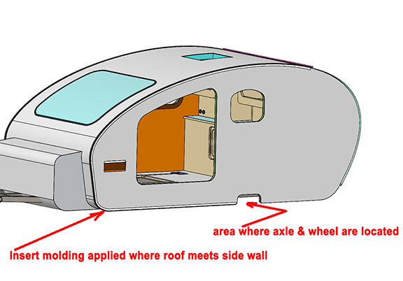

I'm planning on applying insert type roof edge molding (Vintage Technologies) all around the side wall aluminum sheet where it meets the aluminum sheet roof and where it travels around the underneath (at the bottom of the side wall). I've got these two cut outs where the axle protrudes out from the bottom on both sides. I don't think the aluminum trim will be able to bend around the radius corners on those two cut outs as shown in the attached image. I could probably change the molding in those two areas around the cut outs to be some other kind of molding with less of a leg.......or maybe not have any molding in that area as it won't be seen but will then be exposed to the elements..........I'm asking if anyone has any suggestions on how to handle that area.
Thank you for any suggestions.....

Strong but flexible sealant / adhesive
maybe with a "rubber" L trim
3M 5200 is almost too strong, cannot be undone, 4200 may be better
Sikaflex has a good line

John, I sand/dish out the aluminum insert molding for it to wrap around the tight bend.
I then use aluminum channel molding I got at Lowes to do the underside of the wall since it has 2 legs vs the one on the insert molding..
I don't have a dish out area like in your image, so I have no clue how to address that issue.

I too think you can relieve the foot a bit with a belt sander and have it conform.
In the axle area, Vintage Technologies HT09 trim will work fine.

Thanks for the replies. The idea of rubber L trim is interesting in that I can use some heat to soften it and conform it to the bend. I'm using some Trimlok PVC edge trim for the windows which may work for the wheel area. I had considered the HT09 but that is not wide enough to span the thickness of the wall (could use 2 pieces, one from each side. I'll have to ponder this a bit more, but thanks again for the help and suggestions.
John
EDIT: I'm wondering if I even need to put a molding on the dished out area. Maybe the moldings that do run along the bottom can sort of fade out just before the dish out and that dished out area can just be painted to protect it. Any thoughts on that? Thanks!

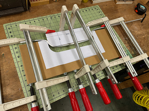

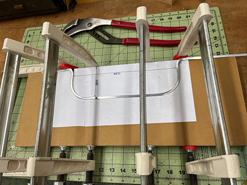

Just a follow up.... I cut out a piece of ply to use as a bending fixture following the outline of the axle area. The aluminum molding bends fairly easily. Kind of slowly clamped down on the the ply pieces with the molding sandwiched between the two..... came out well. This was just a test strip... but think this might work okay. Thanks again for the suggestions.

Capebuild wrote:Just a follow up.... I cut out a piece of ply to use as a bending fixture following the outline of the axle area. The aluminum molding bends fairly easily. Kind of slowly clamped down on the the ply pieces with the molding sandwiched between the two..... came out well. This was just a test strip... but think this might work okay. Thanks again for the suggestions.
John
Very nice

Postby lfhoward » Tue Mar 22, 2022 5:09 pm
Nice work on that homemade jig!
