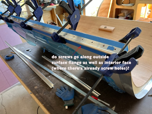

Installing the hurricane hinge on the hatch. I had planned on screwing the hinge flange on the inside edge of hatch.
I'm wondering (asking) if there should also be a row of screws holding it from the outside surface.... holding that exterior
flange up against the aluminum sheet surface.
Thank you for the help.
John

Well,….. I just had a gut feeling there should be screws on that out side flange as well
Then after taking a look in Tony’s book, he suggests that also. Seems good to me. :)

That's what we did. Used Butyl tape along the hinge. So far it's worked great. :thumbsup:
