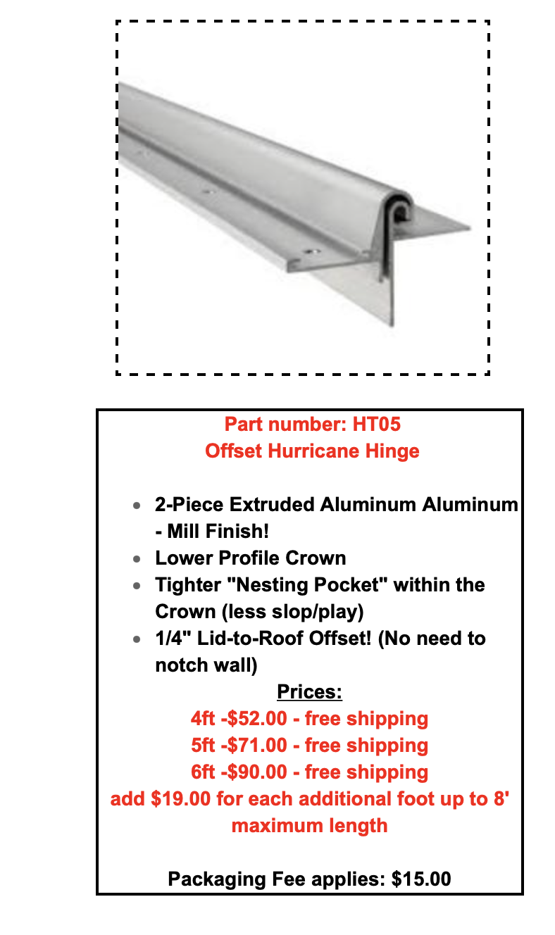

I went back to the site where the hinge was purchased at Vintage Technologies (probably should have done this before I posted the question)
and I see it's called an "offset hinge" (see attached). Says the extra bar offsets the hinge so the hinge itself doesn't need to be notched. But I'd think it also raises the hinge (by 1/4 inch, along with the hatch) which would probably change the way the hatch is positioned.
Not sure I'll use it... and just notch the hinge

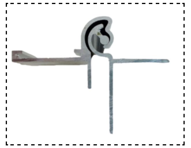

and actually my hinge profile looks more like the first picture.... (with the fancy interlocking shape)
John
