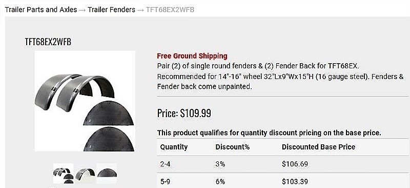

* I bought my 16 gauge steel fenders fom Southwest Wheel in Dallas in 2011, for less than in the picture below, but even at the new prices, they have been worth it. I originally planned to wall-mount them, using the backing plates, but since my frame extends 1" outward from the walls, I took advantage of the spacing, and welded them to the frame (with added bracing on the front and rear fender lips. Since someone jumped on one fender and slightly bent in downward (hardly noticeable), I know that his 280 lb weight would've ripped it from the wall, if attached by thru-bolts or screws. zHere's the current listing for the fenders & backing plates (I presume that the backing plates are available separately, too):
fender & backing plate kit, from Southwest Wheel.JPG (83.57 KiB) Viewed 522 times
* Another point in favor of the added spacing: if ever you decide to get a wider axle or wider tires, you might not need to get wider fenders. I installed a wider, stronger axle a year or so after the fenders were on, and the tires still fit under the fender (though the axle was 2" wider). Another year later, I installed much wider LT tires, and made fender flares to cover the 1/4" that protruded from beneath the fenders. These fenders have been worth it ($48 ??? at the time, I think).
