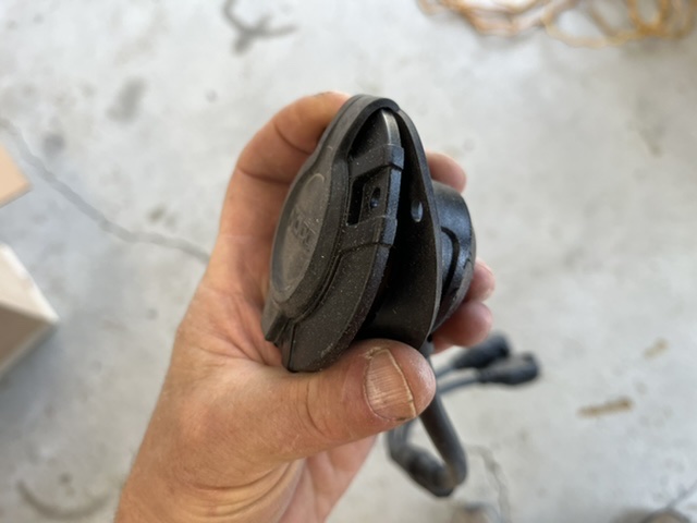

I’m installing a Nocco AC port plug for shore power. It comes with a gasket and is attAched to the aluminum side wall with 3 screws. Do you rely just on the gasket from keeping water out or is it a good idea to put sealant somewhere (like between gasket and aluminum)?
